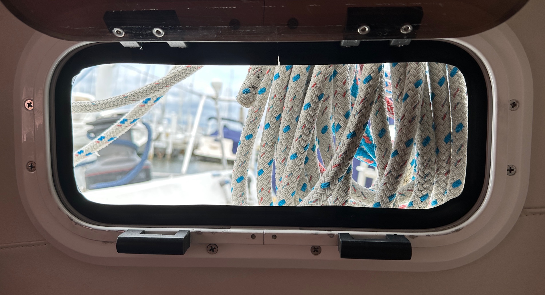

Just a note of caution. I know a lot of us have lines going into the head through the rear window and the rear cabin on the port side, again, though the rear window. Over time pulling the lines in and out wear down those gaskets. I just recently bought two, one for each side. They are 17 euros each. However shipping for them was 55 euros and Gebo would only accept a bank wire transfer for payment, another $25. All together for the two gaskets with the exchange rate, $127

I bought the two gaskets for the rear windows and with the international shipping they were VERY expensive. The kicker is although the interior widow frame comes off fairly easy I cannot see ANY way to get the actual window out to replace the gasket. It appears that the window was put in place using a marine caulk hopefully not 5200 but all of the sealants are VERY difficult to undo and I have for now given up on replacing the gaskets. If anyone has successfully removed one of these windows I'd love to know how you did it.

I left the frames in place on the boat. The rubber seal was pulled towards the center of each frame to remove it from the machined grove it is pressed in. The new seal was lubricated with dish soap and inserted inch by inch into the machined groove. It takes some time, but it does work.

I used these exact part numbers provided by Vento Solare and replaced every single port light gasket with an order from Gebo. The cost was ~$240.
I was able to pull out the old gasket using adjustable pliers. I then cleaned the area and simply soaped up the new gaskets and pushed them in as best as I could and then I closed the window and used plastic trim removal tools to properly push the gasket into the frame all the way.
I would imagine if you don't soap up the gaskets with dish soap, this would be way harder.

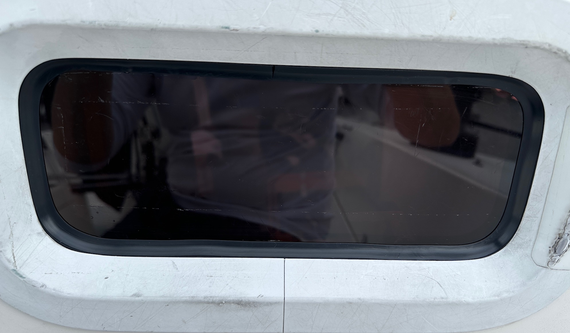

An unfortunate update on the Gebo portlights ... after a change in ownership, Gebo slimmed its offerings and discontinued the "Econoline" port lights that were installed on J/109s. There are still some parts available, including the hinges set, handle set, and sealing rubber. The sealing rubbers are not made pre-formed anymore, so it’s only available to cut out sections that are not on a corner to make a repair.

Just came across this same issue.
I ordered several feet of the sealing rubber earlier this year. It was a bummer they no longer carried the pre-formed seals. It was challenging getting wrinkles out of the seal while going around the bends, but it is possible.
First, clean out the old track very well. Mine had some hard sealant near the hinges. Then, using (and reapplying) soapy water, start halfway at the top and force the seal within the track. Corners are most challenging. I found doing this from inside the cabin provides a better angle. Once you have gone all the way around you will want to cut/shorten the strip to make things more manageable. At this point the corners will still look like garbage. To fix this, you need to stretch the seal within the track. Start by pulling the top tighter and try to spread the tension throughout. Do this a few times. I was surprised by how much it can stretch. Once it is tight enough the corners should have very little or no wrinkles. Cut the excess again to match the starting point.
