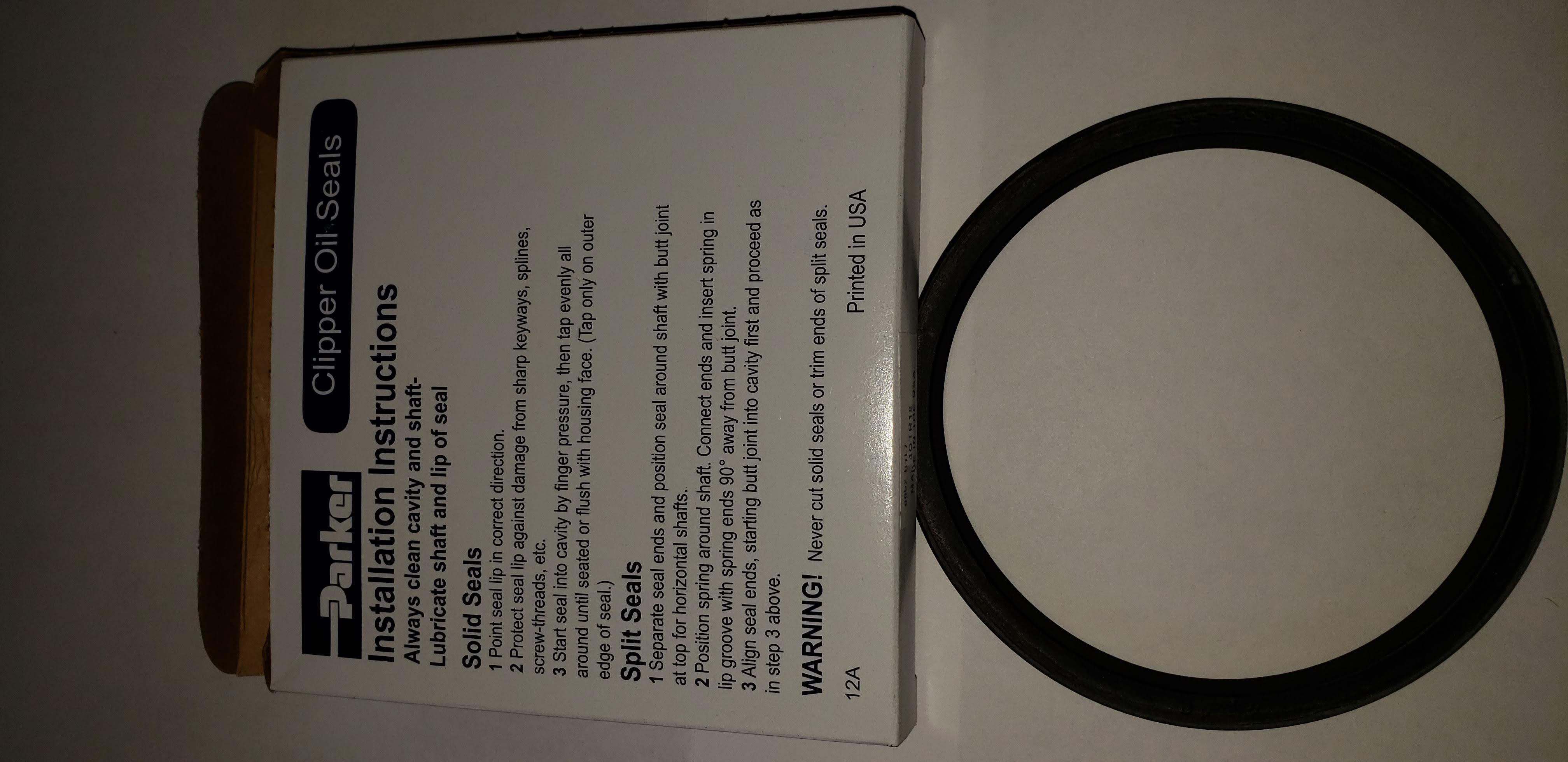

When I purchased Hull 266 I found the sprit leaked on the delivery from Annapolis to Newport. With the boat hauled I have found where the forward seal mates against a seating ring, there was a section of the ring missing (broken off). It turns out that is the forward sleeve bearing, so I am replacing both bearings and the seal. I checked with Waterline Systems and the components for this on the J/109 are the same as the J/105. Here are some part numbers for those who may need to replace them.
Bowsprit Seal - Waterline #86241 (This is a Nitrile Rubber Rotary Lip Seal made by Parker Part # 6652 H1L7 also available elsewhere)
Retaining Ring Waterline #86252 (didn't buy it as it wasn't needed)
Bowsprit Bearing Pair (one inner and one outer) Waterline #92069 - there isn't any manufacturers part # on it.
Re: Sprit Leak
An update for the Sprit seal. I recently ordered a replacement - Nitrile Rubber Rotary Lip Seal made by Parker Part # 6652 H1L7
The supplier had a minimum buy order from Parker and has stock available on the shelf now.
They are available from RI Packing and Insulation, 1903 County Street, Attleboro, MA 02703. Call their phone 401-421-8090 and you can pay by credit card over the phone. They shipped it to me via postal mail and I had it in 3 days. It was just over $50 including shipping and tax.
