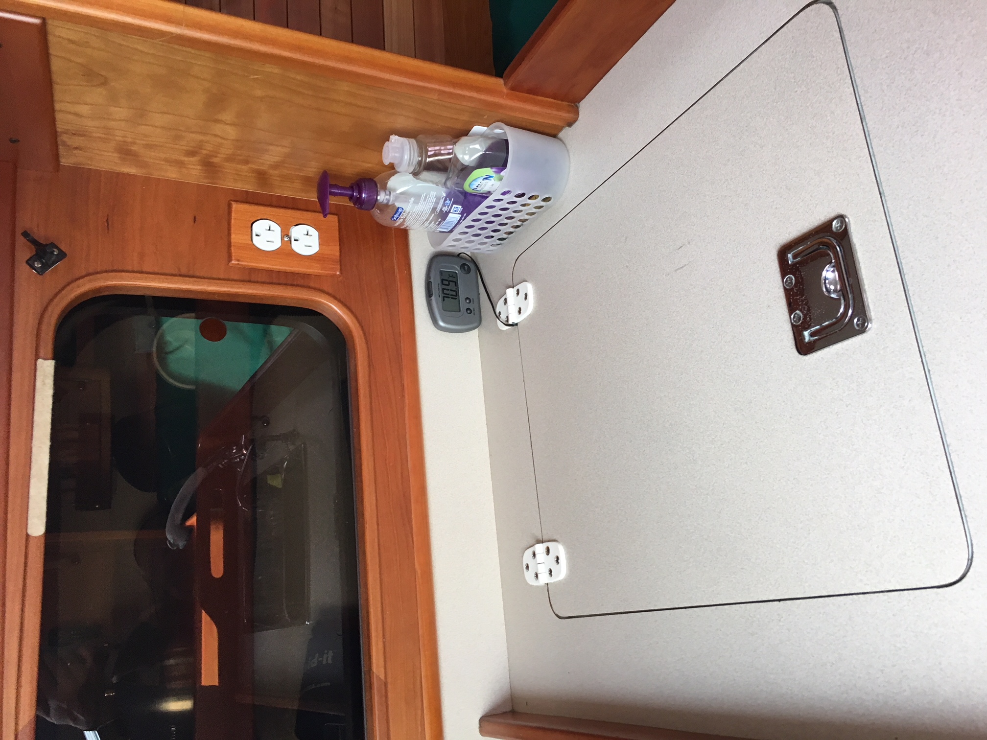

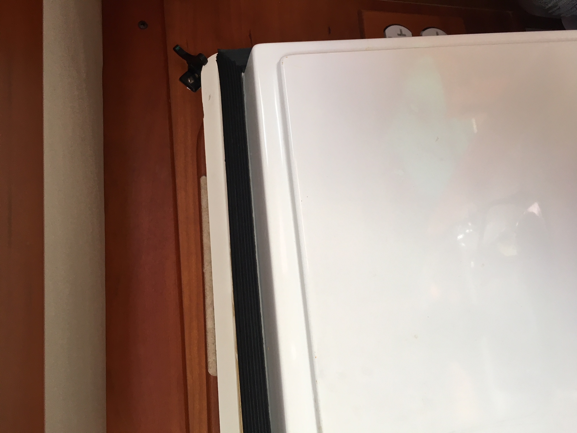

An old post but I thought I would add information on the hinges and spring latch I installed on Vento Solare.
Spring Latch on Defender Website
Suncor Stainless Heavy Duty Flush Door Hinge on Defender Website

This is how our lid is supported. Works very well. The thumb latch will hold it open while sailing.
