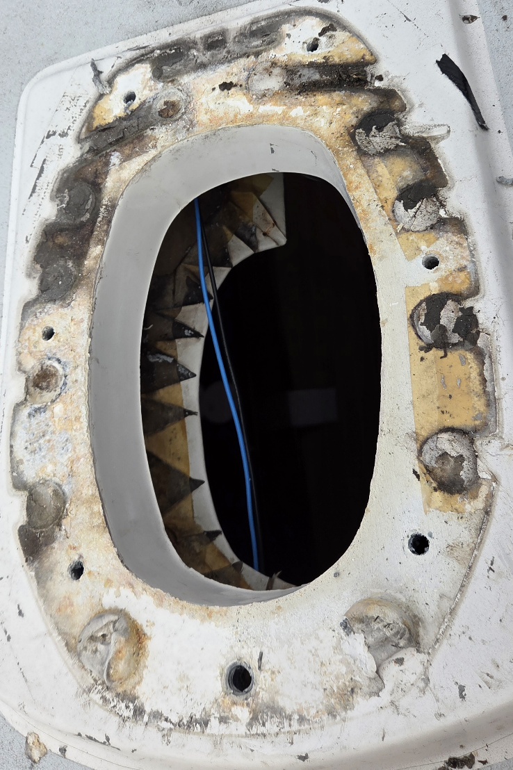

I went through all the above with limited success. So I had the Mast pulled earlier this week.
On the mast itself once I cut away the crispy rubber boot I found many years of silicon where previous people have attempted to stop the leak. The wedge was also very very hard, I have a new boot and wedge
I went ahead and removed the plate. It wasn't very troublesome and I'm glad I did it. I remove the headliner on the port side and was able to loosen the headliner on the starboard side to get a wrench in there. To fully remove the headliner on the starboard side I would need to remove the grab rail bar. The six 5/16 Phillips head screws came out okay however the bearing surface underneath is curved so all of them were a little bent. The large slot head screw for the deck hold down turnbuckle was difficult to remove because of all the sealant squeezed around it.. I used a small pry bar, a block of wood, and automotive trim wedges but it actually popped off pretty quickly with little force other than around the aforementioned large slotted screw. The sealant under there was very dry and did not provide a good seal against the aluminum.
On tap for this weekend will be scraping and cleaning and then reassembling everything with new hardware.
While the mast is down, I'll seal all the holes on the mast.
