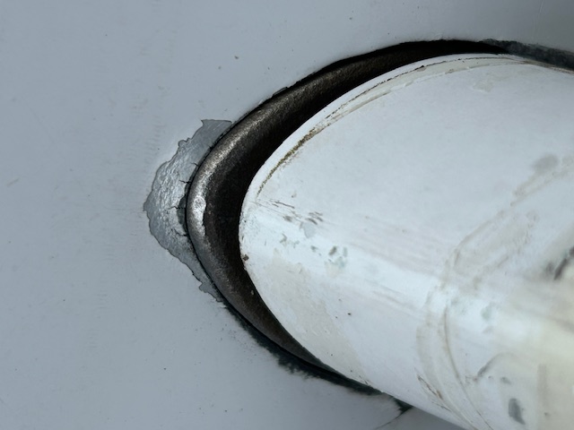

Unfortunately I didn't take many pictures after the fix. The photo below is where the spreader intersected with the mast. There was a lot of wobble at this connection and you can see the spreader bar holding the spreader was starting to wear on the mast.
The spreader bar was replaced and now there are doubler plates that protect this surface of the mast.
