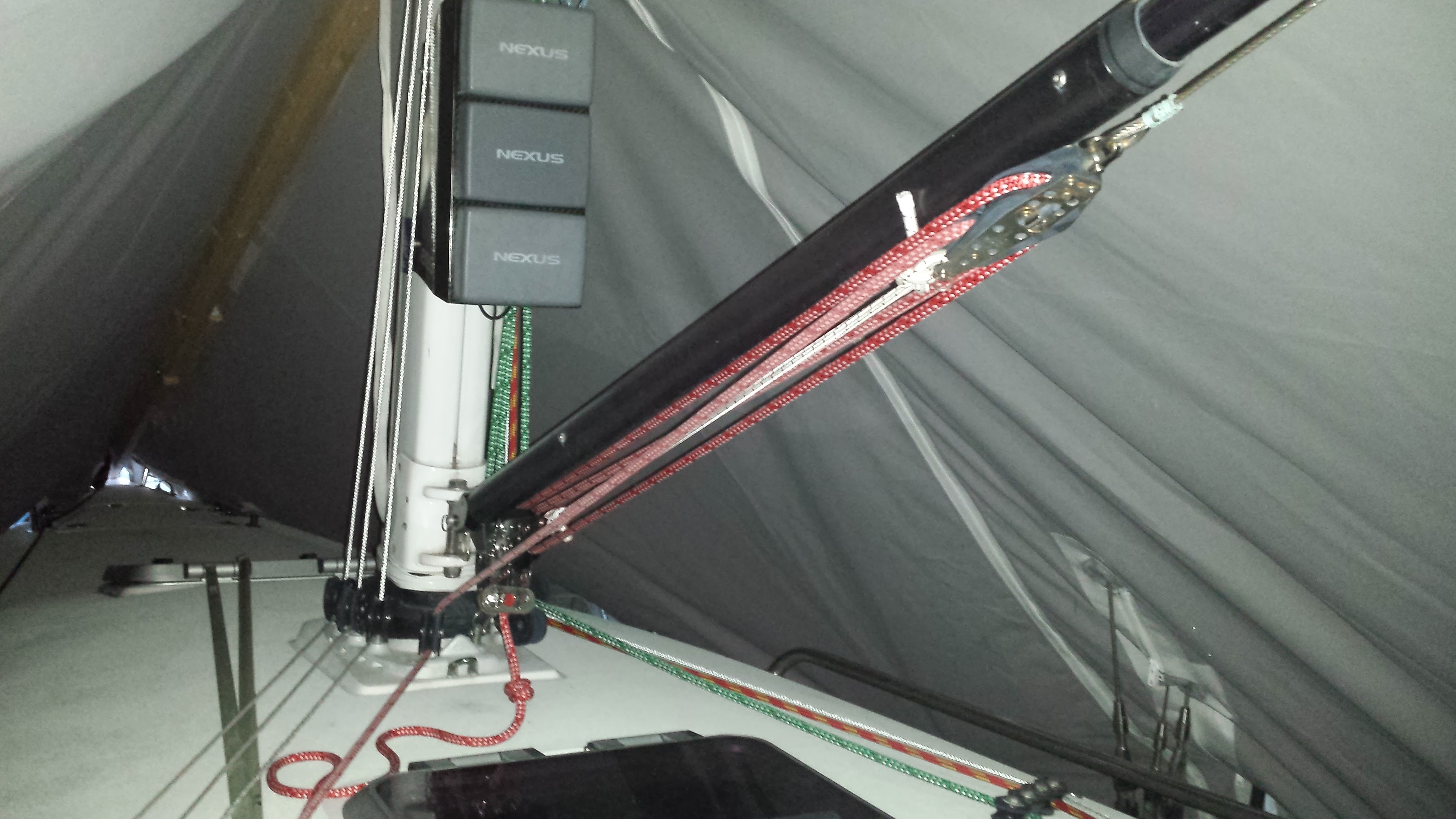

I am curious, would you have a picture of how you made it double-ended?
My vang is squeeking, the manual says to put grease on the spring, with no specifics about how to get to it other than a parts diagram. Have you done this? What is involved? Is this difficult or time-consuming? Thank you for your insights always!
Re: Repeating Vang Settings
This is an old picture that shows the mast end for double ending. The lead aft goes through the deck organizer and uses the port inboard Spinlock clutch. You can follow the Harken Vang Manual diagram for disassembly and reassembly.

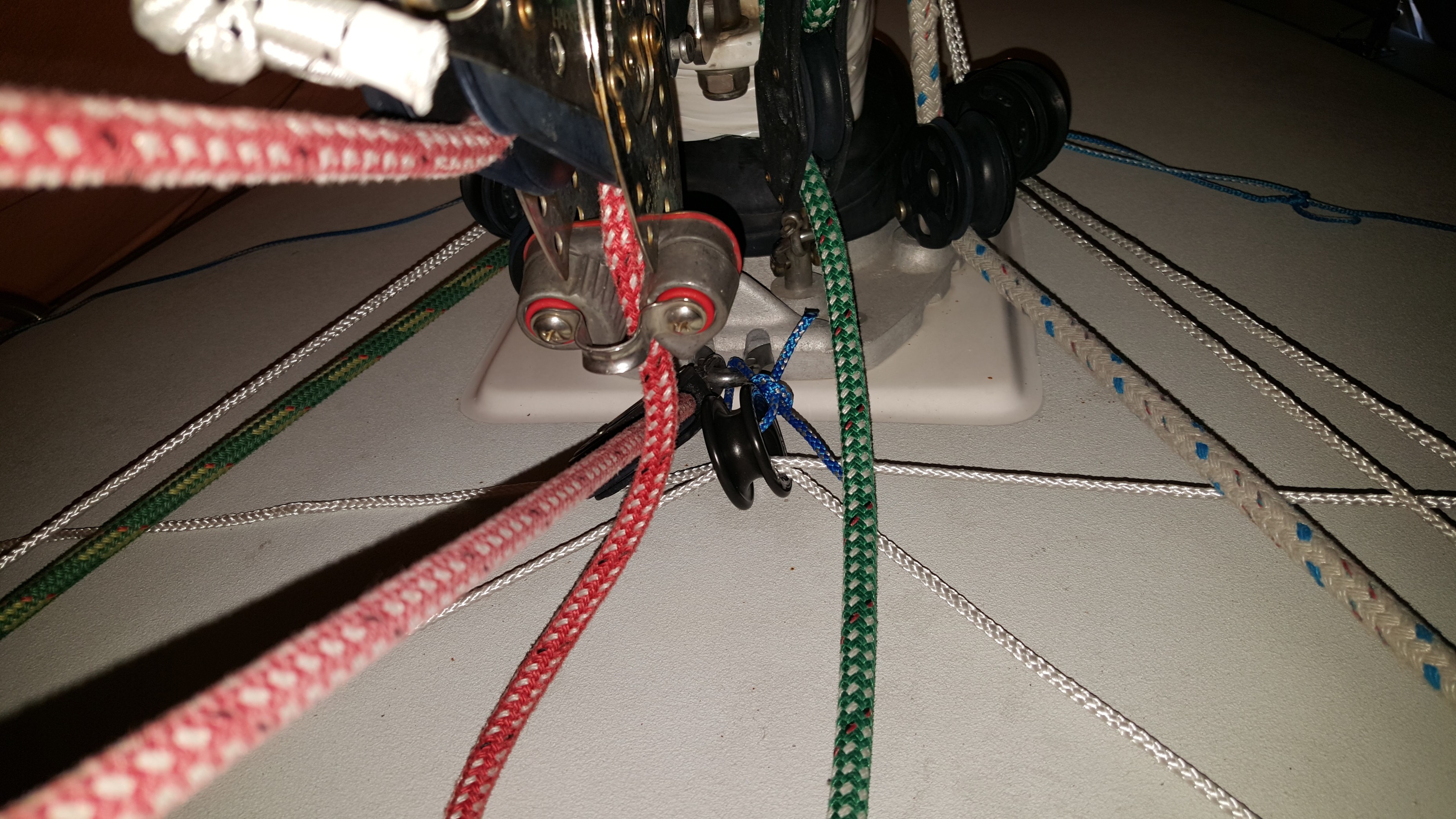

Improved with turning block at center
turning-block-vang-base (1).jpg (1.52 MiB) Viewed 8641 times
