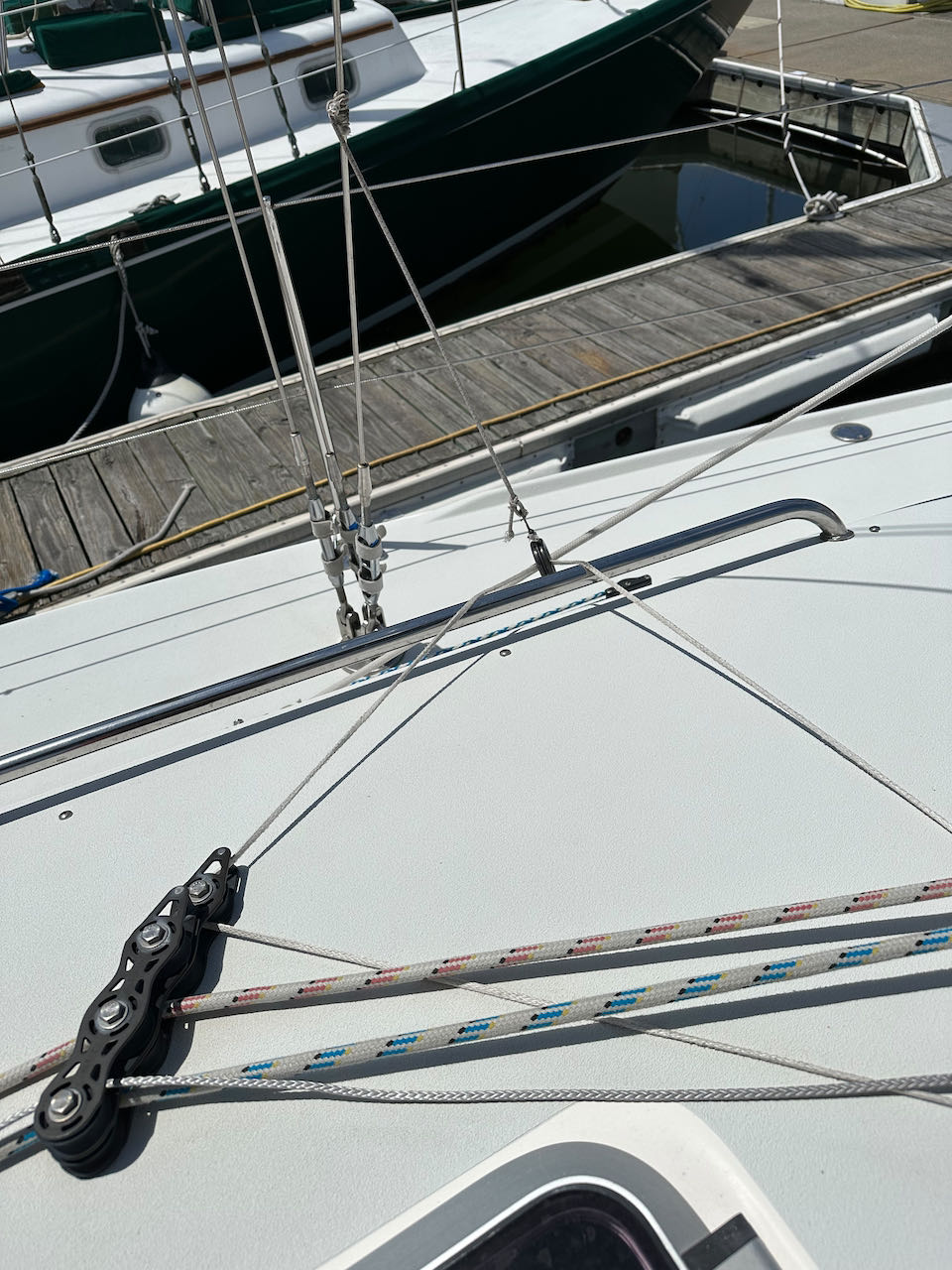

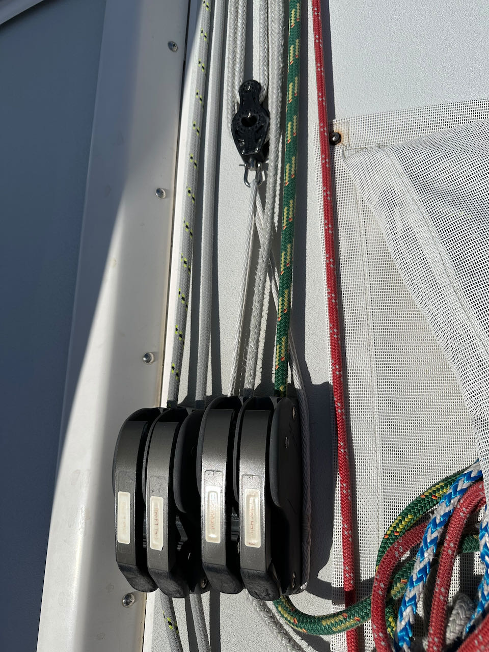

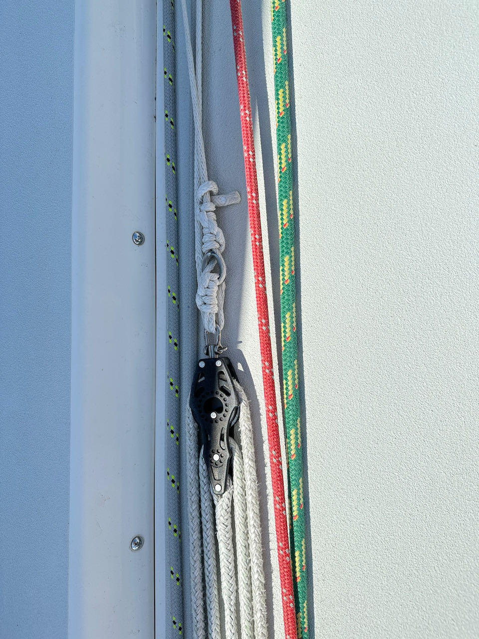

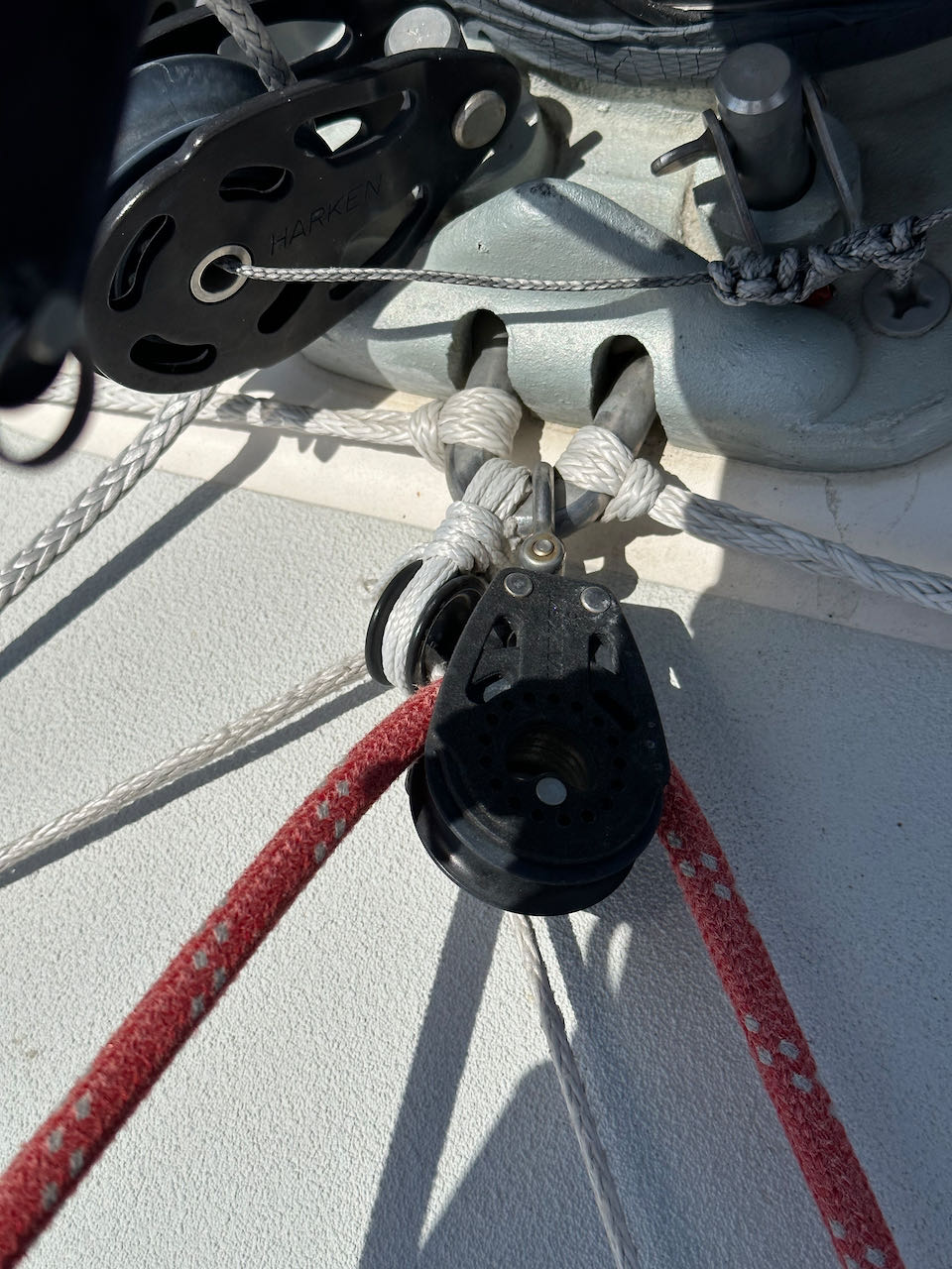

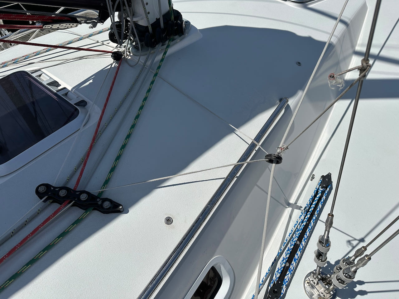

Photos of my inhauler setup.
The shock cord ends have gotten a bit ragged after a few years, but the cord doesn't last more than 3-4 years in the sun anyway. Next replacement cycle I will tie them with perfection loop or overhand loop knots (theoretically better than a bowline in shock cord) and trim them up with the hot knife. Tie some whipping around the ring, and then tie the shock cord to the whipping. Looping shock cord around the ring allows them to pop out too easily.
Easom used Antal size S R 30.56 friction rings to accommodate hard jib shackles. I've switched to soft jib shackles would would probably go down several ring sizes.
I've been thinking of moving the control line to a cabin-edge jam cleat, similar to the vang, for faster access, but the lever cleat works well enough.
