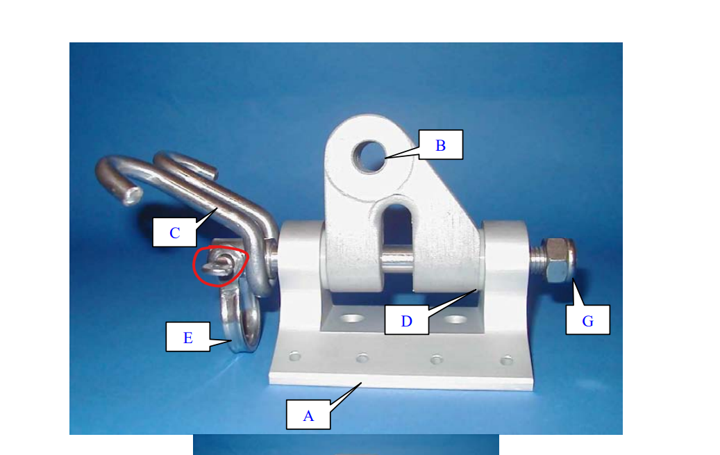

Bill, I don't have a black band either, When you say "even with the hole in the boom fitting that the mainsail tack is attached" are you referring to where the bow shackle attaches ?
Screenshot 2025-09-22 142129.png (380.76 KiB) Viewed 5935 times
Re: Trying to measure mast rake - no black band
Yes - that is the correct datum point.
