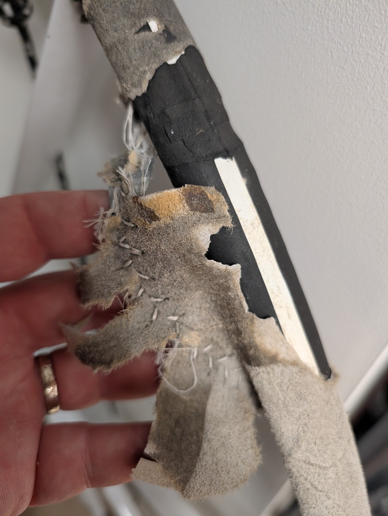

I am working towards my winter project of recovering and potentially repainting my wheel.
1) The attached photo shows what is underneath my current cover. I am wonding if the gray soft material stays or is removed before putting on the deluxe wheel cover.
2) I am missing paint across 20% of the surface area of the wheel spokes. Wondering if I should sand that all off as part of this project.
Thank you
Thank you

Dan,
Remove all the leather and foam. You get new foam and leather with the kit. I sanded the chipping spots and sprayed an etching primer. Once that cured I used a spray can of white epoxy appliance paint.
Some pictures below when I did this task previously. The trick is to keep the leather wet so it stretches while you sew the seam.
