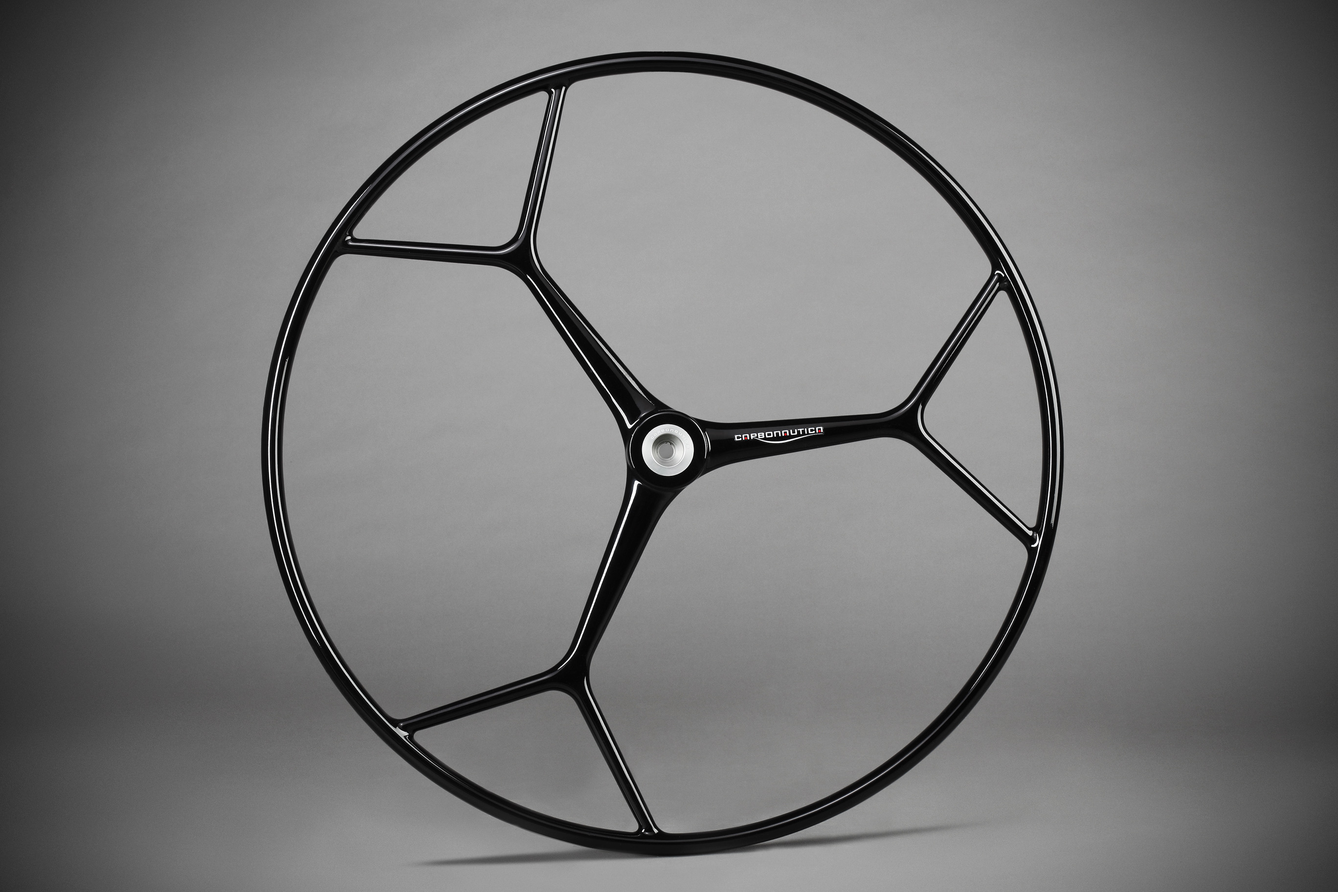

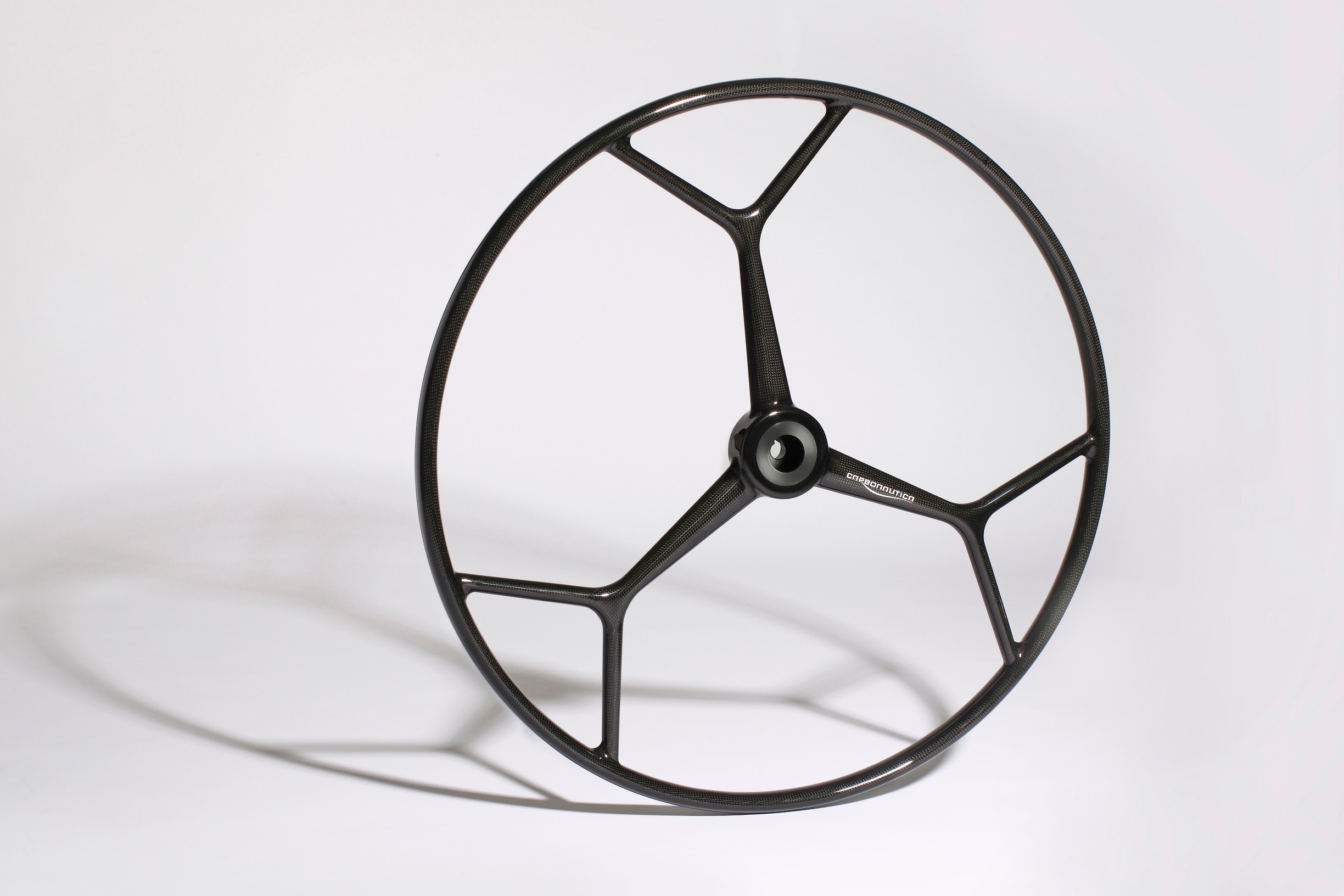

Brennan Hale from Bristol Yacht Rigging who was the individual who contacted me originally just sent the following information about the Carbonautica Wheel used on some of the European built J/109s along with photos.
From: John at Carbonautica
Sent: Thursday, January 28, 2021 4:29 PM
To: Brennan Hale
Subject: J/109
Hi Brennan,
Thanks for your enquiry- we have supplied the j109 with a 1500mm wheel here in the uk before.
It’s available in a glass / carbon painted version ( $2640 ) - 4kg
- and in Clear Carbon ( $3570 ) - 3.2kg
The wheel is legal here in UK as it doesn’t directly increase the speed of the boat. Unfortunately I do not have any official info for the USA - however - as it doesn’t directly increase boat speed only handling and responsiveness compared to the steel wheel- it may be ok. (there is a significant weight saving between the two wheels but not significant in relation to the boat weight overall.)
Wheel despatch is 4 weeks from receipt of funds.
Delivery is as per Dhl / fedex best rate.
If this offer is of interest please advise and I’ll get a quote ( $300 max approx )
Best, john
Further to my last mail - here are a couple of pictures of the wheel - also comes standard in white and grey. We can custom paint as well. Any solid RAL colour. ( not luminous or metallic though)

Re: Replacement Wheel for Helm
All US built boats came standard with a 54" Edson Diamond wheel, no options was available from the factory. This wheel is still readily available, therefore no class legal substitutions are allowed for US built boats.
French built boats, as far as we can tell, came with several options from the factory first a 48" Edson Diamond wheel, then a 50" aluminum wheel made by Lewmar and last an optional 59" carbon wheel made by Lewmar. The 59" wheel was recessed into the cockpit floor. Any of these options are allowed as replacements for French built boats.
Class rules 1.2, 1.4 & 4.1 are about specifications, modifications, repairs and factory supplied equipment. The TC's interpretation is that the J/109 came with two slightly different "as built" factory standards that must be followed. It is not class legal to pick and choose options between these two standards, US built boats must follow the US factory standard and French built boats must follow the French factory standard.
