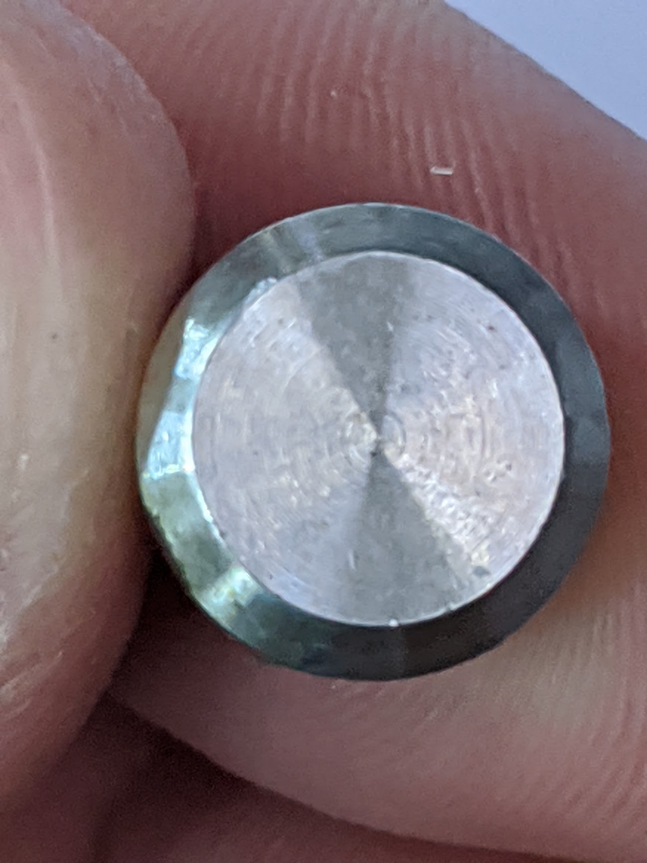

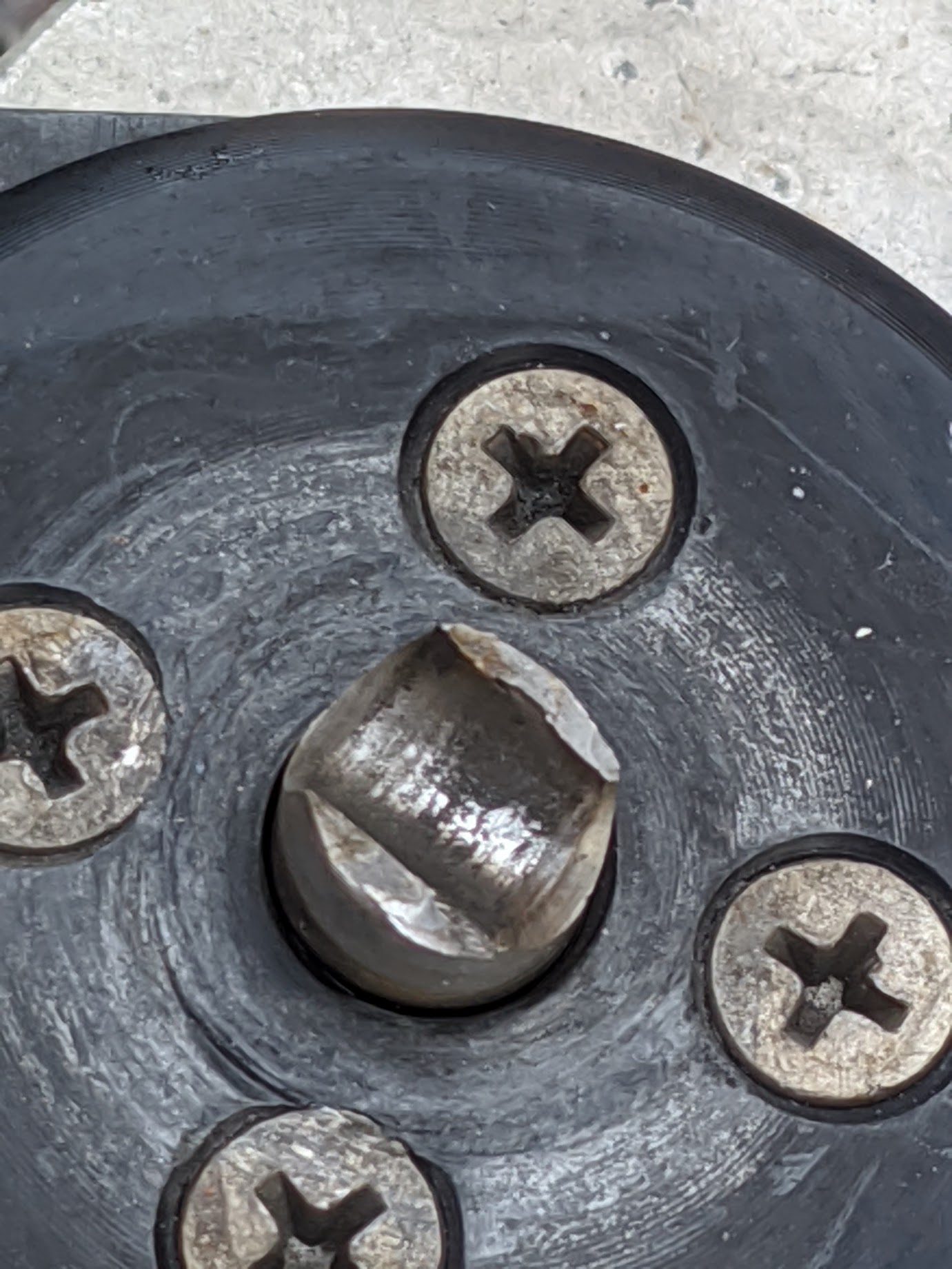

In 17 knots of wind, the enhanced mainsheet swivel broke. Pin sheered across middle of hole.
Re: Mainsheet Swivel Strengthening Modifications Allowed
Was there any attempt by the main trimmer to absorb the shock as a controlled gybe? There is a limit on how much over-engineered this gets. The plastic cap is much stronger now.
ps from the look of the pin that sheered it is apparent there was an older crack that had the discolored rust stain. You should still inspect this periodically as you should do for all rigging components.

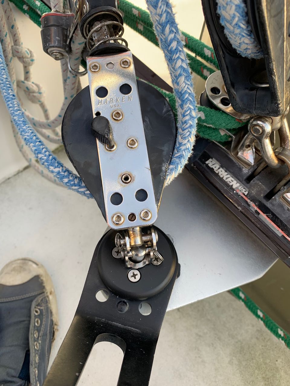

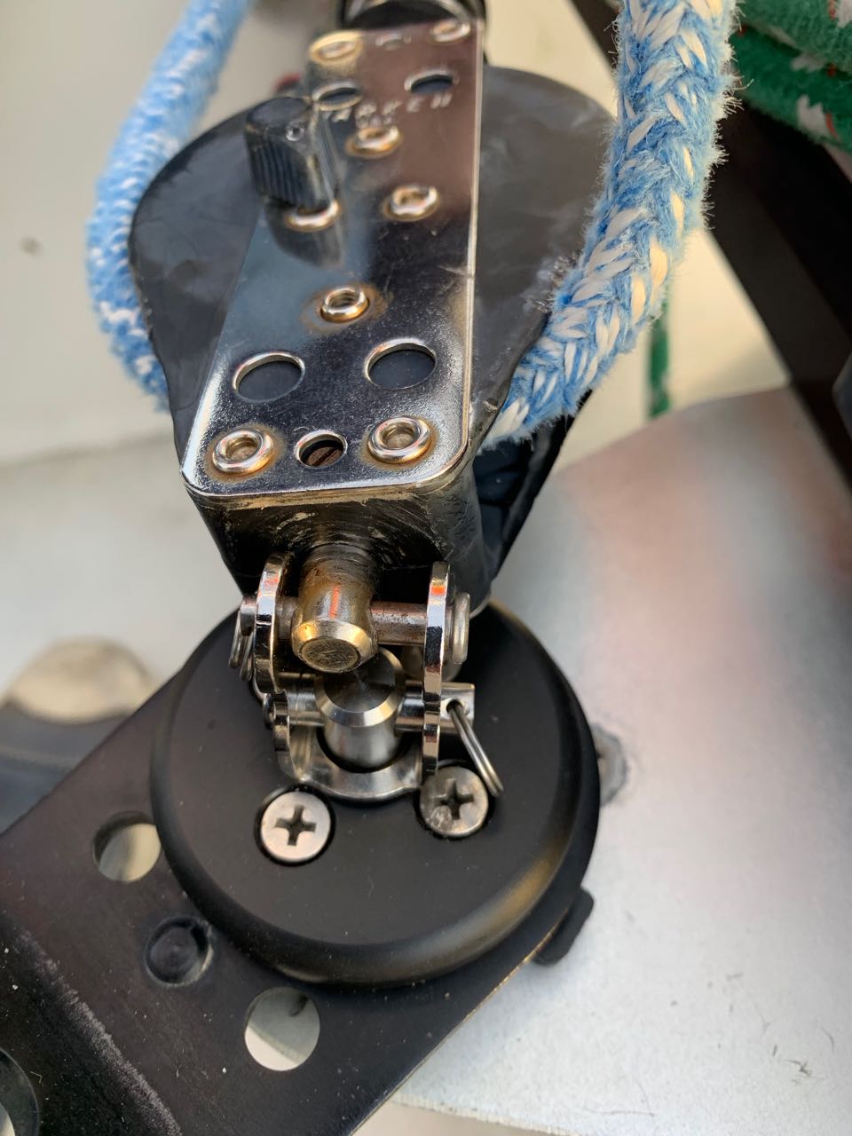

      Finally got around to installing this upgrade and here is a photo of the difference between the two 75mm blocks. Mine had the version with the smaller lower pin, though the hole had begun to elongate, so I upgraded to the newer one.
      It is called the Harken 170 HEXA-CAT block. Also pictured here is the part number for the mainsheet base upgrade (OMB0109) available from Oyster Bay Boat Shop. Here is the link for a video of Bam showing how to build it. https://www.youtube.com/watch?v=M7qIcazqdA0 The U adaptor faces up.
      This is the correct block to accept the larger pins from the upgrade kit.
