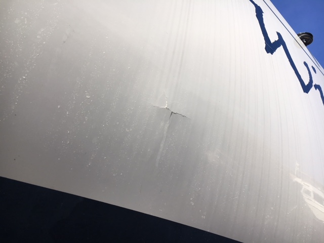

This just happened to Hull #240 - 2005 vintage. Has anyone seen anything similar? Yard thinks it was a void beneath the gelcoat that had water in it than froze. I am a little skeptical . . .
Re: Bubbles
I concur that it was probably frozen water that expanded. The question is how did it get there. You probably want to use a moisture meter and see what the area looks like. Since the area will need to be ground out and patched, you should take a core sample and see what is there.
I did core replacement work on the J/30 I previously owned and had areas of wet frozen core that cracked the fiberglass.

Thanks. I bit frustrating after all of this time. I suppose I will need to have the hull tapped to see what else is lurking beneath.

I am the new owner of hull 240. The water infiltration came from the radar post that had 6 inches of black water in the tube, likely for years. The water then infiltrated the core and then froze. I am in the middle of fixing the damage. The first thing I did was drill a hole in the radar post where it meets the hull inside the boat and 6-8 inches of black water poured out of the radar post. Sealing the radar post would have also been a great idea but no one bothered to diagnose the problem - so they didn't know.
I drilled about 40 holes 1/8" on the inside hull and had a heater on it all winter to dry out the core. The hull now meters dry. I will soon West Epoxy the holes and repair the freeze fracture.
Joel took very good care of this boat so thank you to Joel. The yard on the other hand? This mystery was no mystery at all, and took about 30 minutes to discover the source once I noticed the ice fracture. This was easy to discover and not all that difficult to repair. The outside of the hull had been fixed once - but the yard never took care of the cause, so it returned. The external repair was that of an amateur. I first noticed the bad paint job but on closer inspection I noticed the ice fracturing.
If you have decided to keep your radar dish you should drill a small hole in the bottom and see if water comes out of the post. The polyester resin that these boats are set up with will not keep the water out of the core if the water sits against the hull for any extended time period.
Sadly, all that needed to happen was the make sure the radar post was properly sealed and all of this could have been avoided.
I took the radar off of the boat as I intend to race her and that also solves the leaky post issue permanently.
The other area where water gets in to the hull is where the water bladders sit up against the hull. The hull changes temperature radically this time of year. Today, the hull was 80 degrees on the under side of the hull where the water bladders are situated. The cold water in those bladders meets the 80 degree hull and condensation forms on the inside of the boat. I plan to place a thermal barrier in between the hull and the tanks to mitigate the condensation issue.
