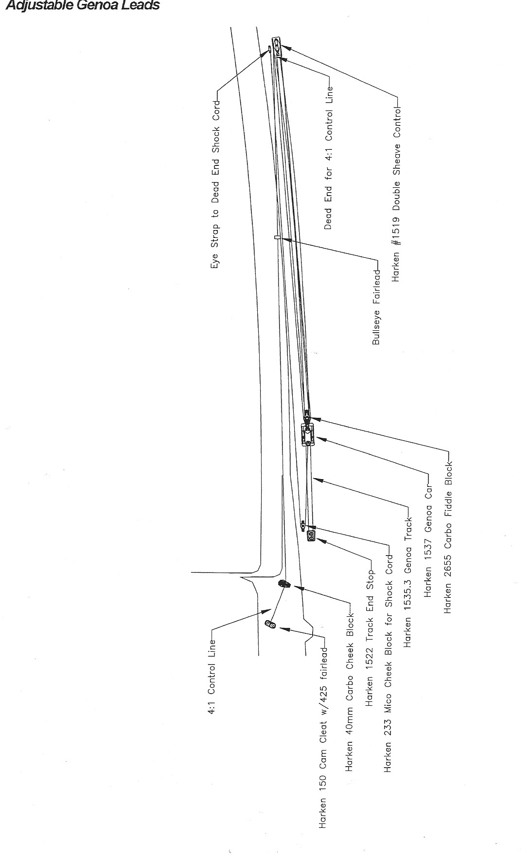

The following drawing added to show existing class legal system
proposed class rule amendment, jib car adjusters

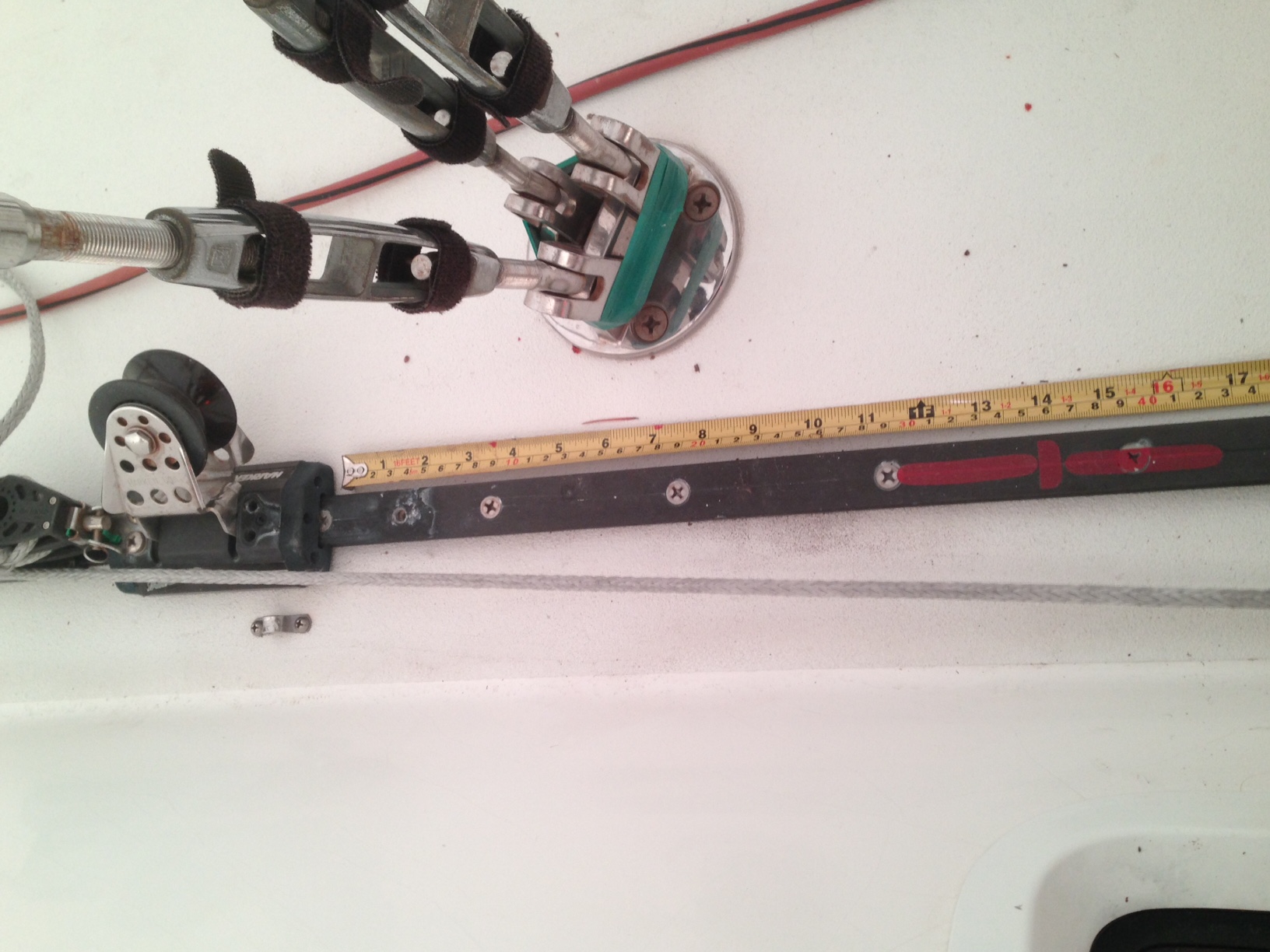

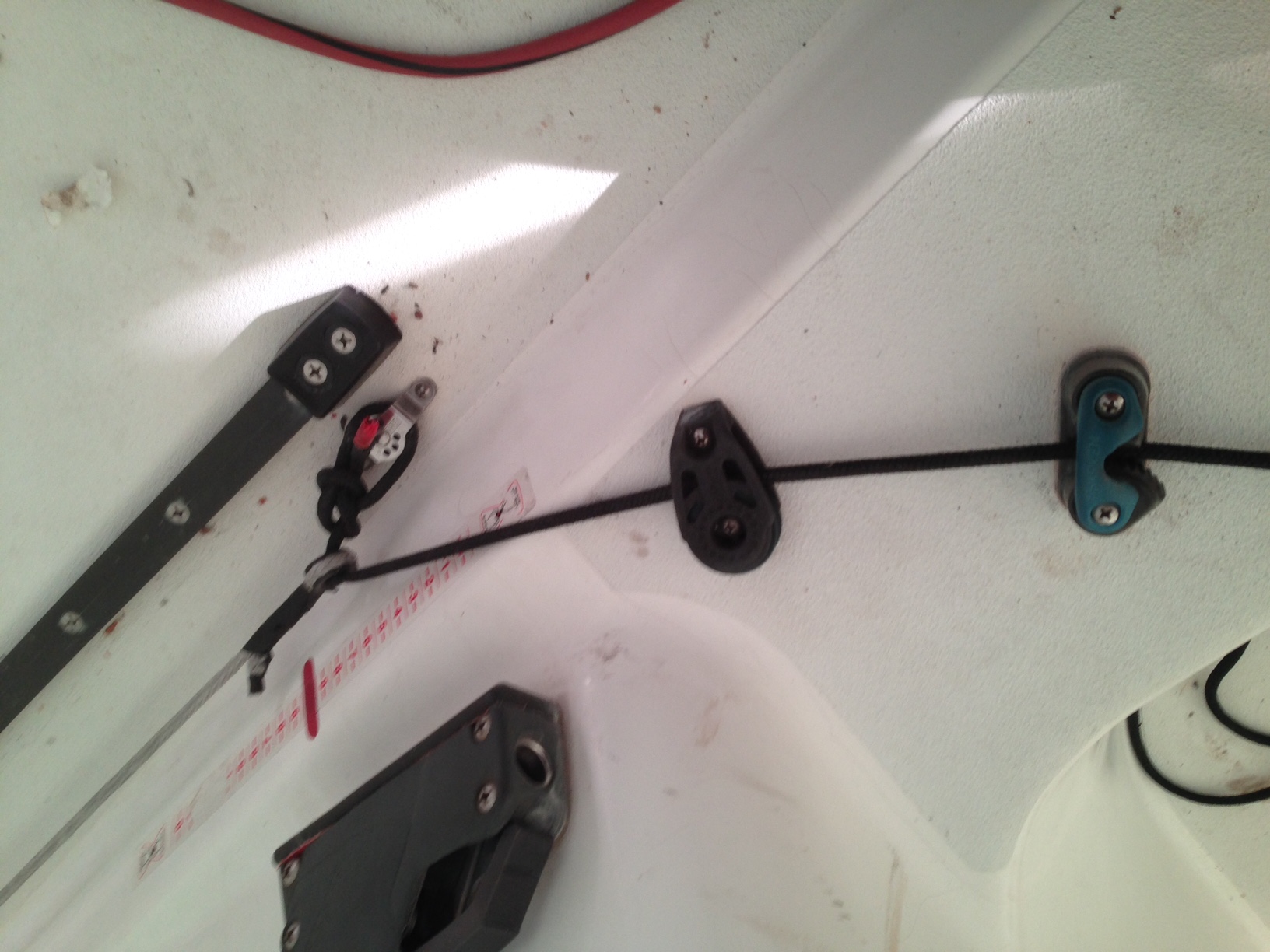

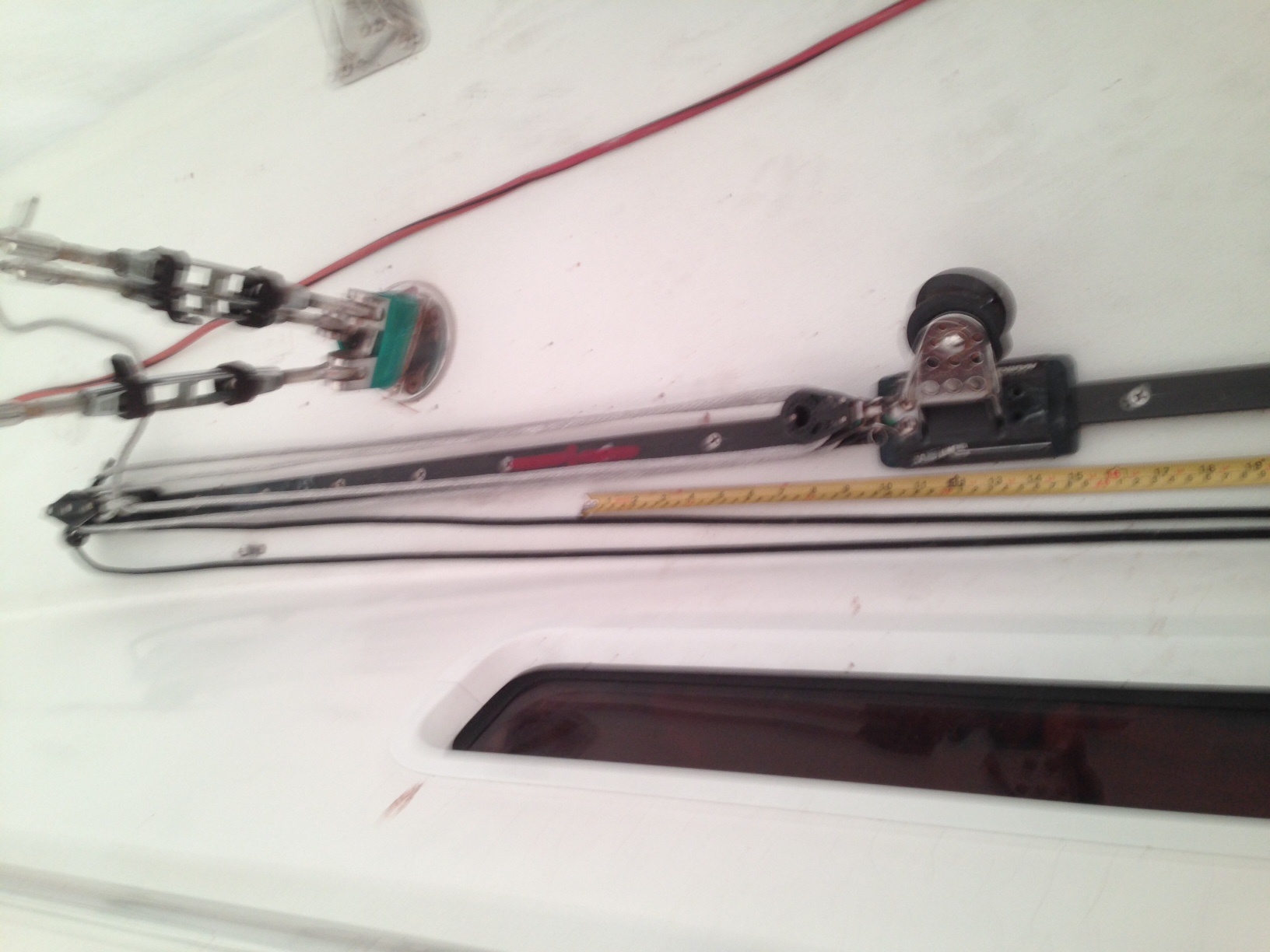

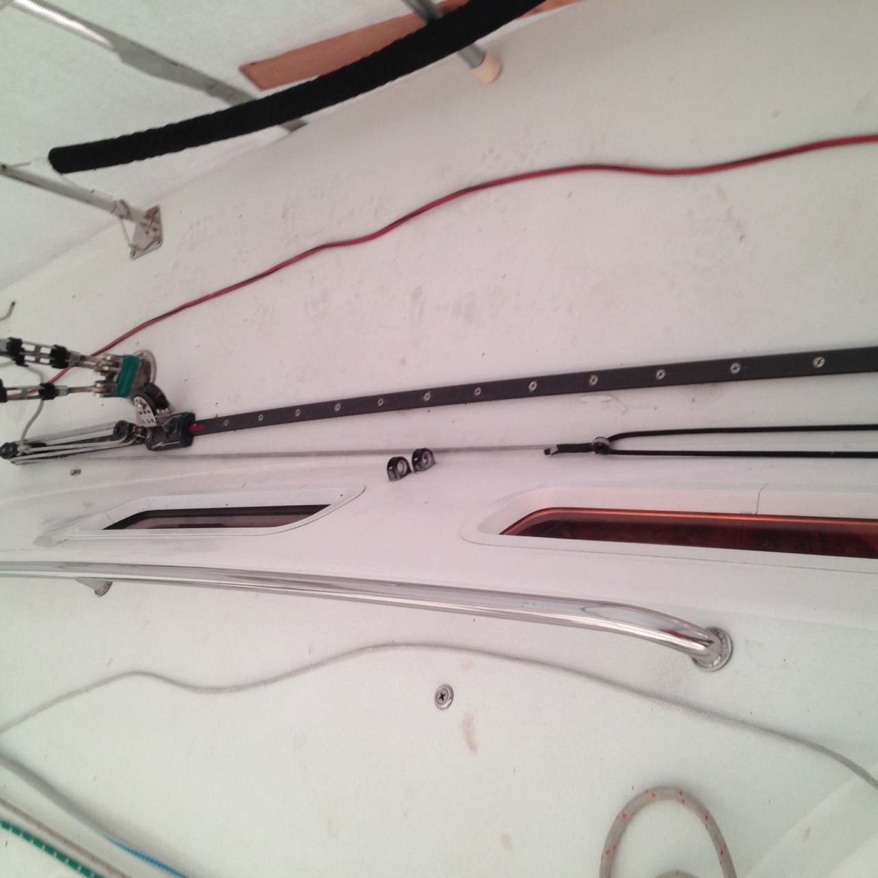

I have gotten a few requests to explain/show how the standard 4:1 plus a 2:1 cascade could work. I rigged a temporary system on Zig Zag today. The distance from the forward turning block on the track back to the termination point at the back end of the track is 122" giving us a maximum travel of the jib car of 30 1/2". in our case that is +/- 15" around the base position for the class jib. These dimensions will vary somewhat boat to boat.
- Termination of back end of cascade
- IMG_0701.JPG (431.66 KiB) Viewed 35531 times
- Jib car at base position, showing the turning ring for the cascade

- Jib car max aft, ~ 15" behind base position, showing the low friction ring of the cascade preventing the car go further aft
- IMG_0704.JPG (357.36 KiB) Viewed 35531 times
- Jib car max forward, ~15" forward of base position
- IMG_0703.JPG (450.01 KiB) Viewed 35531 times
