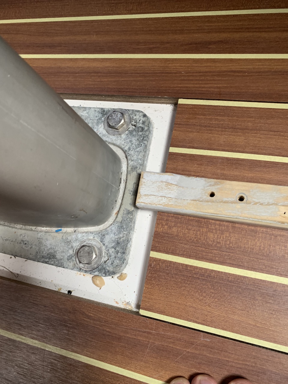

Mine does not have a trim piece to remove. Maybe none of the French boats have a trim piece at the bottom of the bulkhead?

Re: Mast base location?
Not sure - FYI I posted this document with pictures on the Tips & Tuning section of the website back in 2015.
https://j109.org/docs/procedure_to_set_ ... sition.pdf
The 460mm is from mast to bulkhead, most boats had to drill new holes for the mast base to get to 460mm.
Looks like I will have to drill new holes to really get the mast in the right position. The existing base bolts required quite a bit of effort to remove them from the factory bores. Just so I have a sense of what to expect, what material is under the gelcoat beneath the mast base? Hopefully, that strong material extends for another inch or so toward the bulkhead.
On Zig Zag the base is at least 1" thick (hull #37 built by TPI) at factory holes and new holes ~1" forward.
I suggest to move the base to get to 460 mm and then drill new holes in the middle of the slots this will give some flexibility to fine tune the location.
