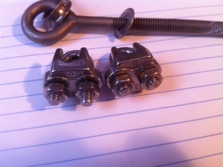

Remove 2 cable holders off each cable (2 nuts on each holder at tip of U bolt)

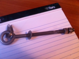

12mm open ended fixed wrench - loosen and remove 2 nuts off ends of 2 threaded eye bolts
Put straight tool tip in eye to prevent rotation
Remove cable and threaded eye bolts from radial wheel

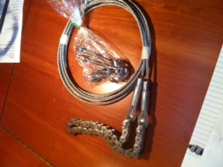

These all get replaced and are included in the chain/wire/cable kit

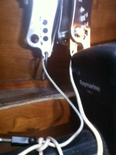

Tape tracer lines (about 5-6 feet long) to end of cables
Pull chain and wires out through top of pedestal. Have someone down below to help tread up wires.
Secure both ends of tracer lines

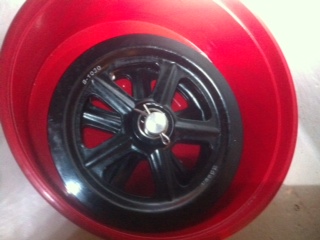

Remove split pin and center bolt from 2 sheaves and check needle bearings. If needle bearings are falling out, replace (this was the case with mine). If good, clean and lube with Teflon lube.
Cable holders_s.jpg (32.75 KiB) Viewed 8929 times
threaded eye bolt_s.jpg (30.74 KiB) Viewed 8929 times
chain and cable kit.jpg (38.25 KiB) Viewed 8929 times
tracer lines thru sheave holders_s.jpg (47 KiB) Viewed 8929 times
sheave with center bolt and split pin_s.jpg (32.94 KiB) Viewed 8929 times
