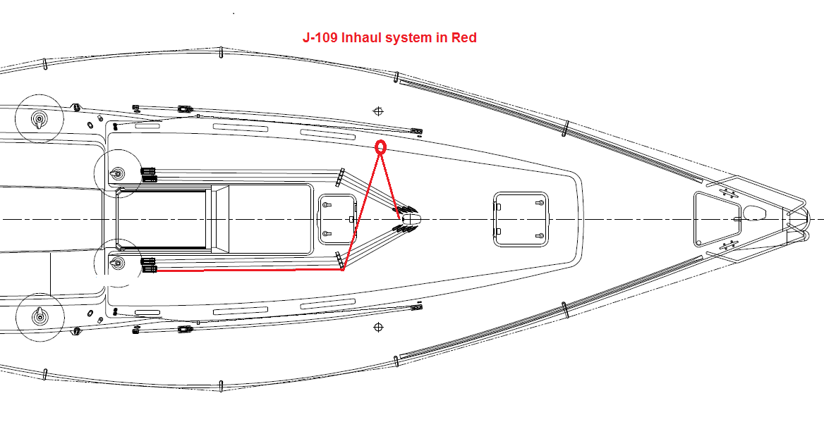

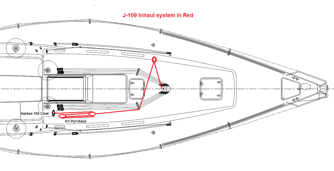

I have added two diagrams which have been submitted with the original proposal. Diagram A which is a simple arrangement using existing hardware to in haul the jib and diagram B using a block and tackle system (similar to the J-88 configuration).
- In Hauler without additional blocks
- 109.A.png (75.58 KiB) Viewed 48445 times
- In Hauler with additional blocks
- 109.B.png (77.06 KiB) Viewed 48445 times

Quick question on the inhauler drawing you posted with 4:1 purchase. Is the aft block (Harken 2637 I presume) anchored to the cabin top? I don't see the system working unless the aft block is fixed. If it is fixed, It may make sense to drill and mount a cheek block.
Another question - do you think there is too much friction if the spectra from the mast center lead through the friction ring is lead back through the stainless U at the base of the mast before leading aft? I''m thinking this would prevent interference with the hatch aft of the mast.

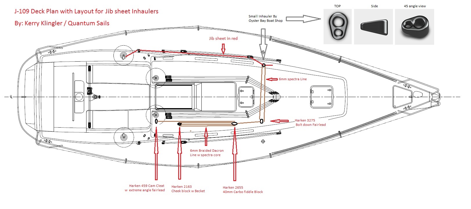

Dear J-109 sailors,
There was a lot of people asking about the hardware and rigging needed for inhaulers on the J-109. Attached is a drawing of what I have in mind. The drawing has only one side of the boat drawn in, understand you will need duplicate hardware for both sides of the boat. The Small inhauler lead ferrel is being developed now and will be available soon. This is a custom hardware by Oyster Bay Boat Shop. If you have any questions feel free to contact me at 914-924-3466.
Kerry Klingler

Re: In Hauler Systems
Thanks for posting Kerry.
For those who use the approach that Kerry describes above, make sure that the Harken 3275 Bolt down fairlead is properly mounted to the deck. The holes should be epoxy isolated and it is a good idea to install something like a G10 backing plate to spread the load. Below is a photo of the backing plate setup I made for Vento Solare. The inhaul system installed on Vento Solare is slightly different and can be seen at this link.
