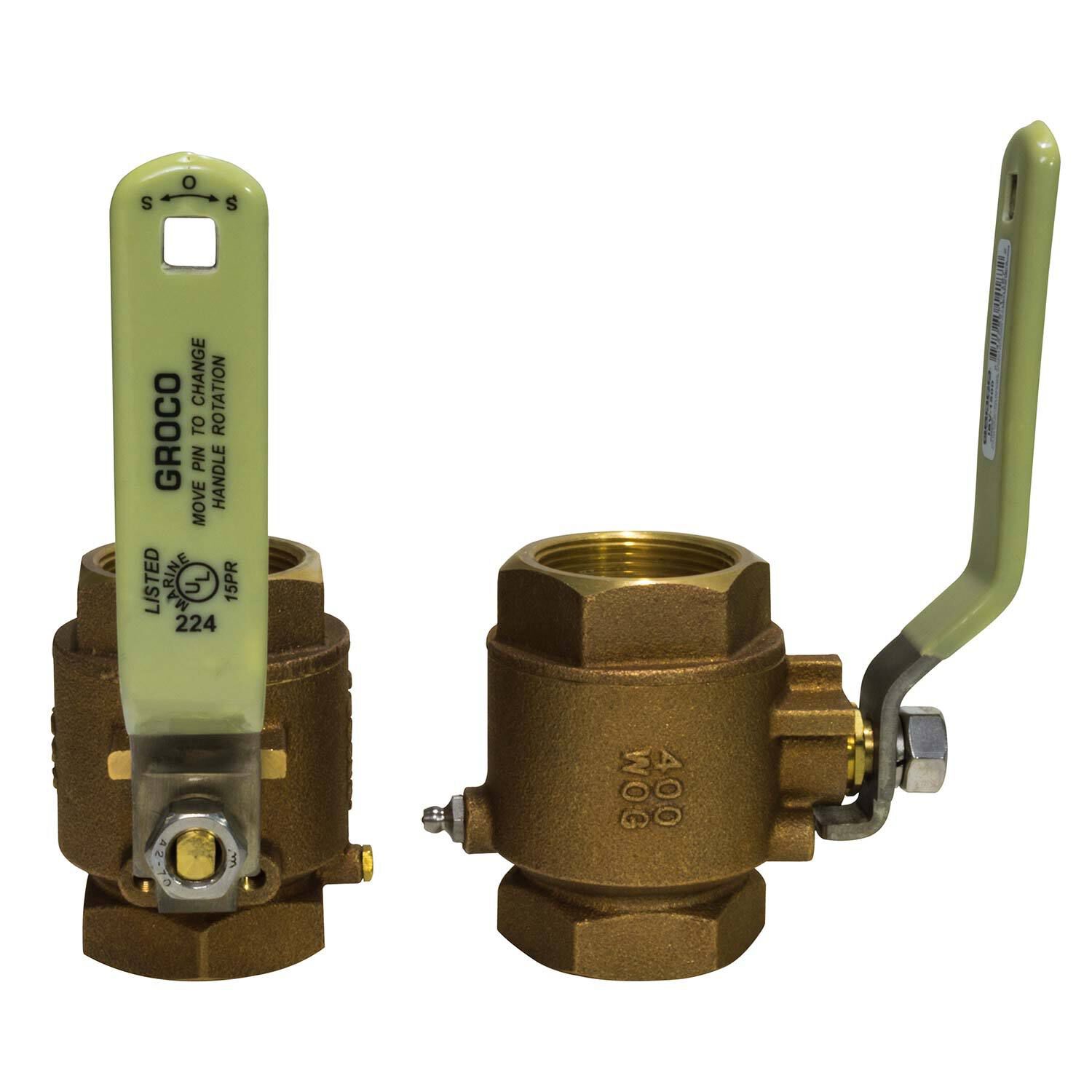

Todd - even though the Volvo valve is plated brass, I think a DZR Bronze valve would be better suited for seawater. Something like the Groco IBV-500.

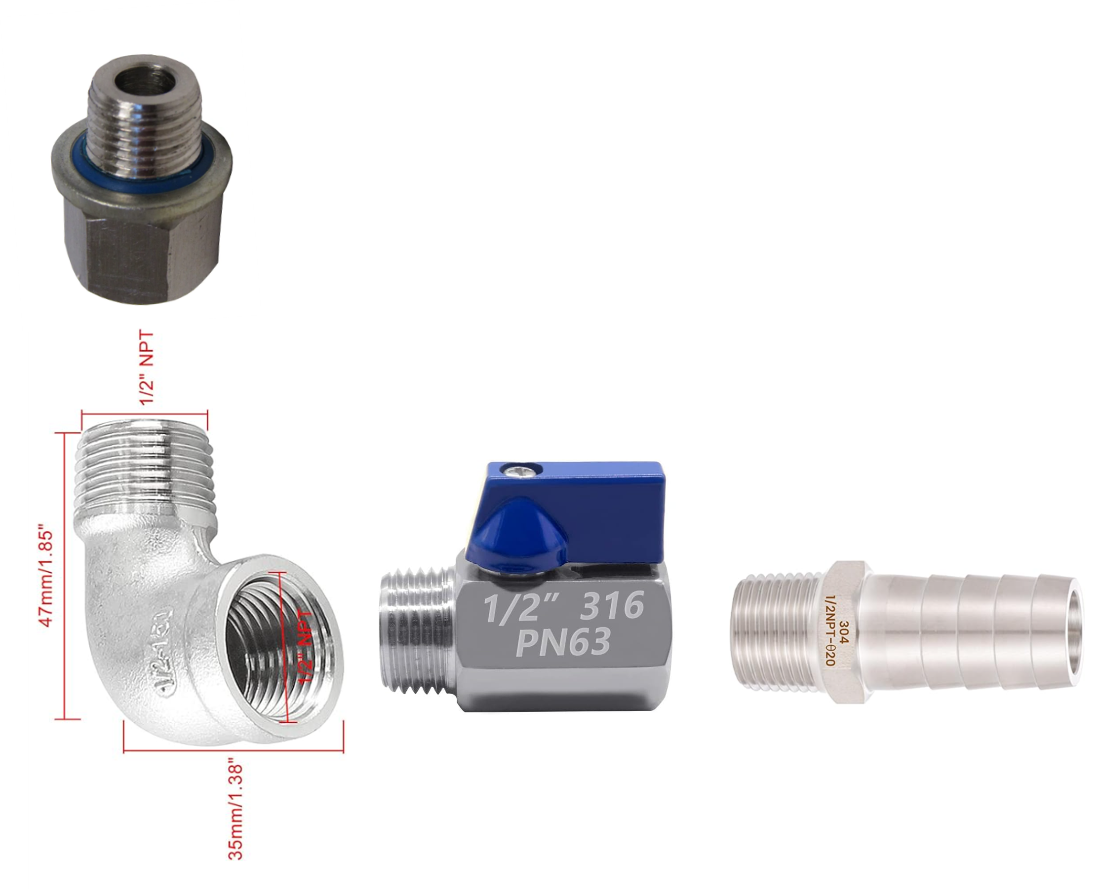

I did some more online searching and came up with a stainless steel approach. The following should screw into the saildrive with BSP threads and provide direct transition to an NPT thread. A 90 degree male NPT to female NPT elbow provides a transition to a stainless ball valve with male/female NPT threads. Finally 1/2" NPT to 3/4" hose barb provides a connection to the existing hose that leads to the seawater strainer.
