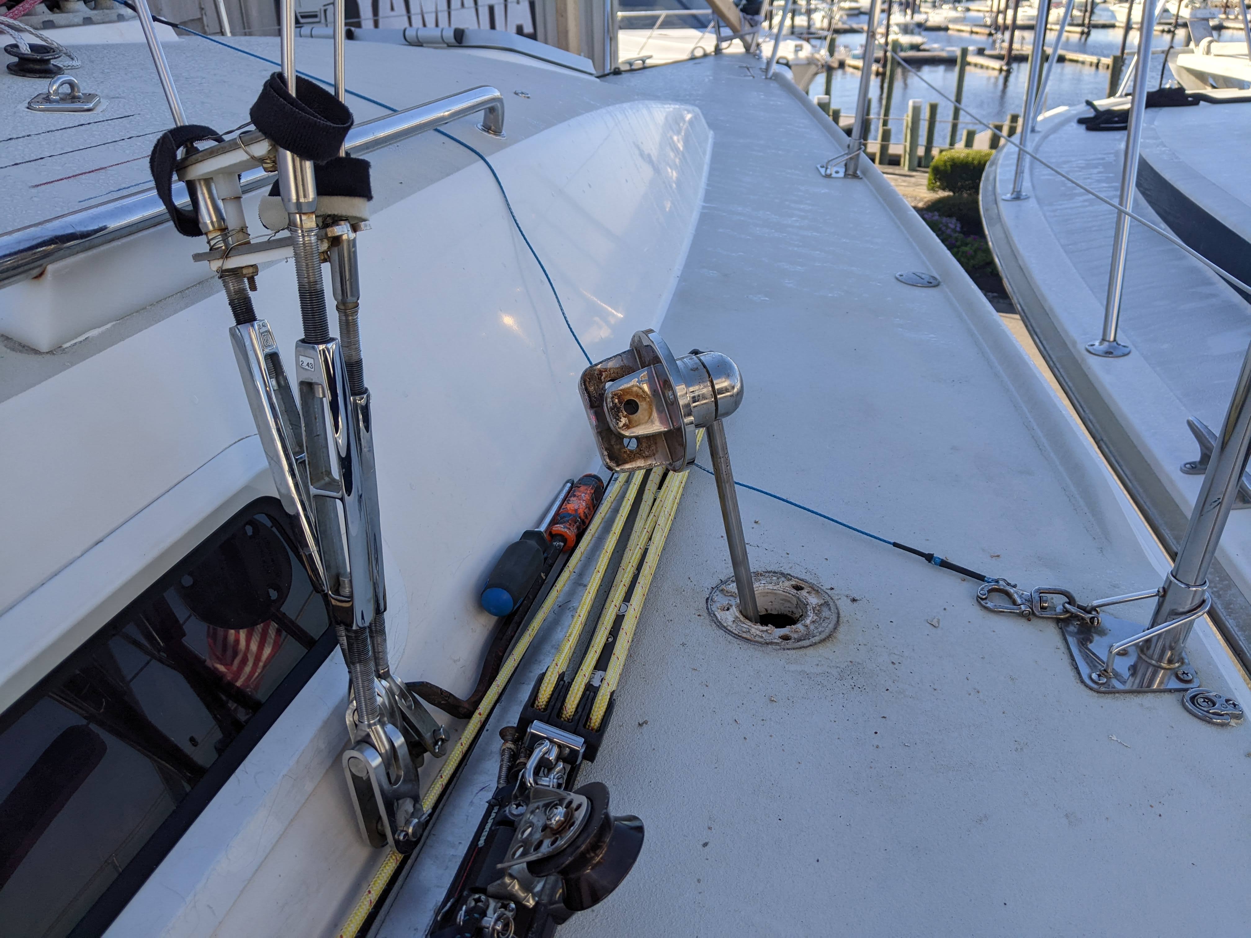

This is how I attach an outboard lead.
I put Wichard 6mm folding padeyes #6684 that are bolted with backing plates along the deck seam just aft of the stanchion by the shrouds. A block is clipped on the padeye and the outboard lead run outside the lifeline to the clew. The inside runs to the cabin top winch.
The picture below was taken when I was resealing the chainplates, but you can see the padeye.
- PXL_20221103_174756205.jpg (1.02 MiB) Viewed 30249 times
