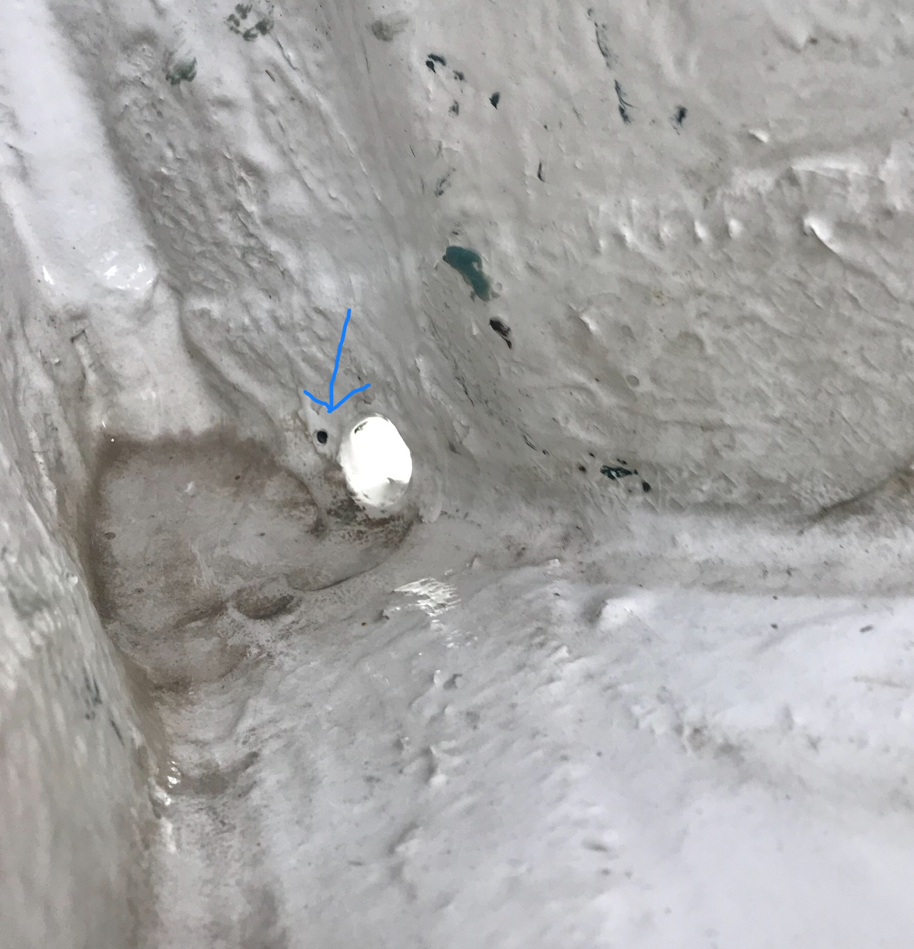

Re: Boat Storage, water question
It was by far the biggest mystery leak for us. At the bottom of the locker there is the drain hole and on the outside of the boat there is a chrome scupper plate that directs the water aft. That plate is held in place by 2 or 3 small pan head screw. When that plate was screwed in place it penetrated a void in the tabbing that helps form the anchor locker. The screw or possible pilot hole went through into the locker. As the locker filled with water in big air and waves going to weather the locker partially fills with water. The water found its way to that screw hole at the seam and into the bilge. When we did the hose test it was crazy how much water and how quickly it went to the bilge/sump. FYI I have read in other post about the chain locker construction being a bit of a headache.FerdinandMac wrote: Thu Jan 31, 2019 9:35 am The anchor locker leak seems odd as heck. Did you get to the bottom of that one, Mike?
- 34BB095F-5A2C-4D63-9540-815F47259497.jpeg (518.92 KiB) Viewed 43171 times
