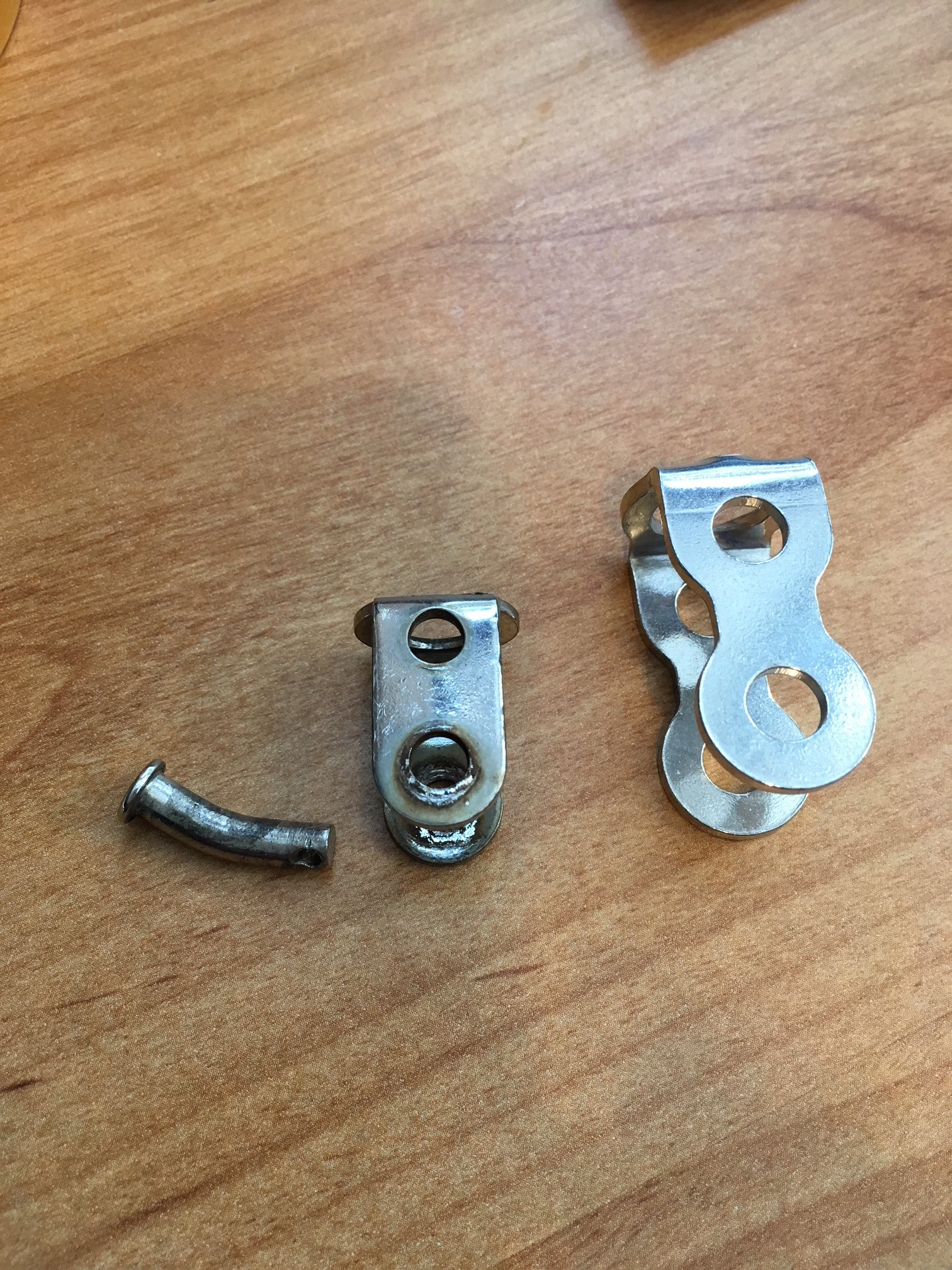

The replacement U adapter info:
Item number H-29180A, Description: U-ADPT FOR 1/4in PINS J109
I attached a picture with the old U adapter next to the new one. As you can see, the new one is much larger. Hopefully this will prevent the U adapters from breaking in the future.

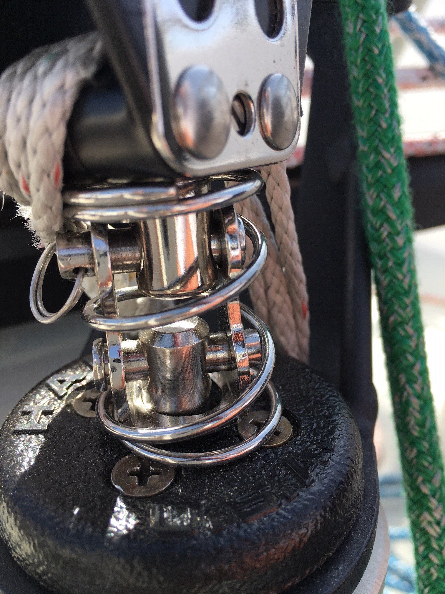

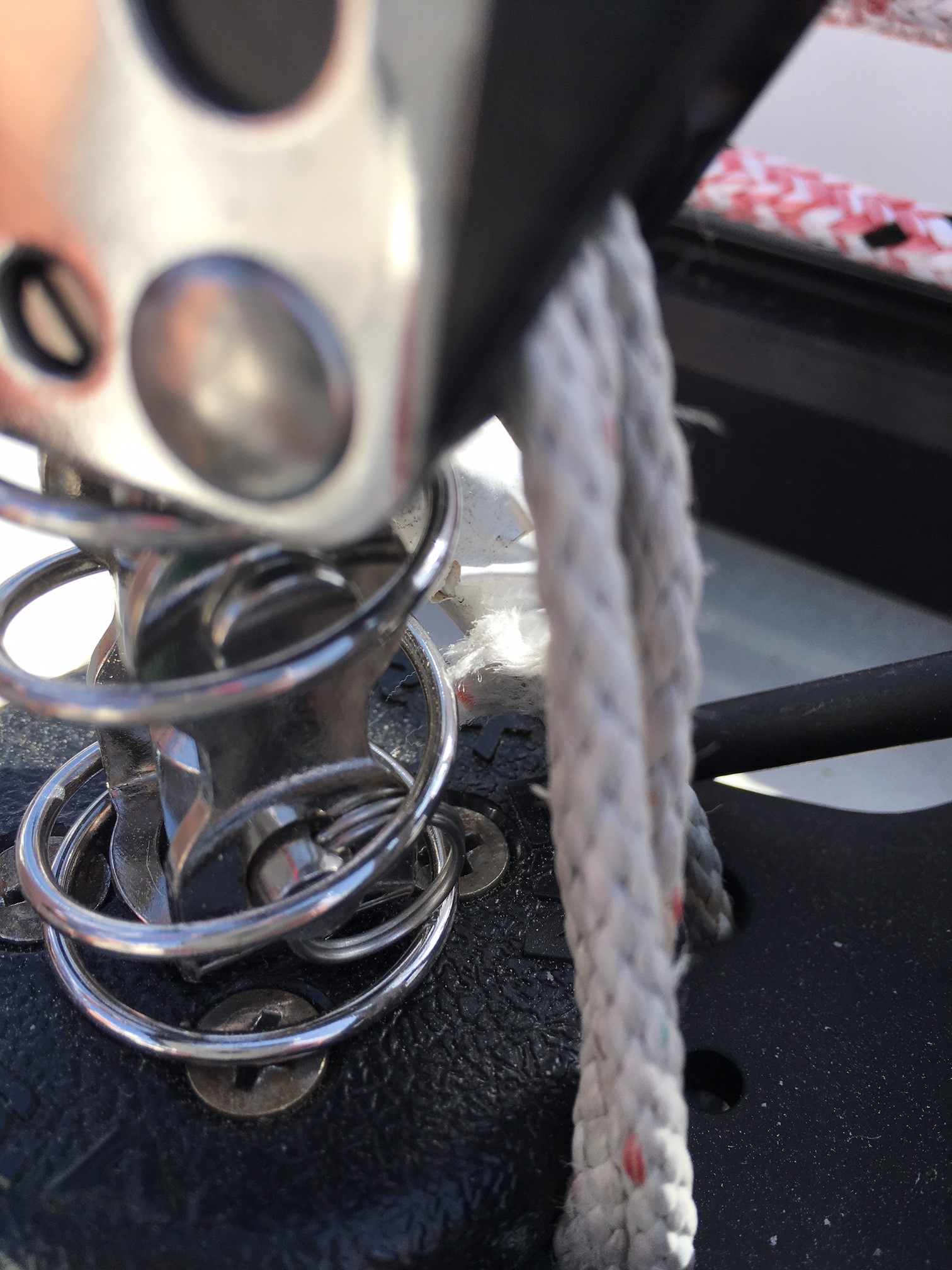

This past week with big wind at the NAs three boats blew up the plastic swivel plate that holds the upright clevis pin attached to the lower block. Additionally many boats deformed the stronger Harken model H-29180A, U-Adapter with 1/4in pins made for the J/109.
This winter I will look at the possibility of fabricating a small stainless disk that fits over the plastic swivel and is bolted using the existing 4 screws. Something like this should take the load off the plastic piece. If successful, I'll suggest that Harken may want to incorporate the upgrade.

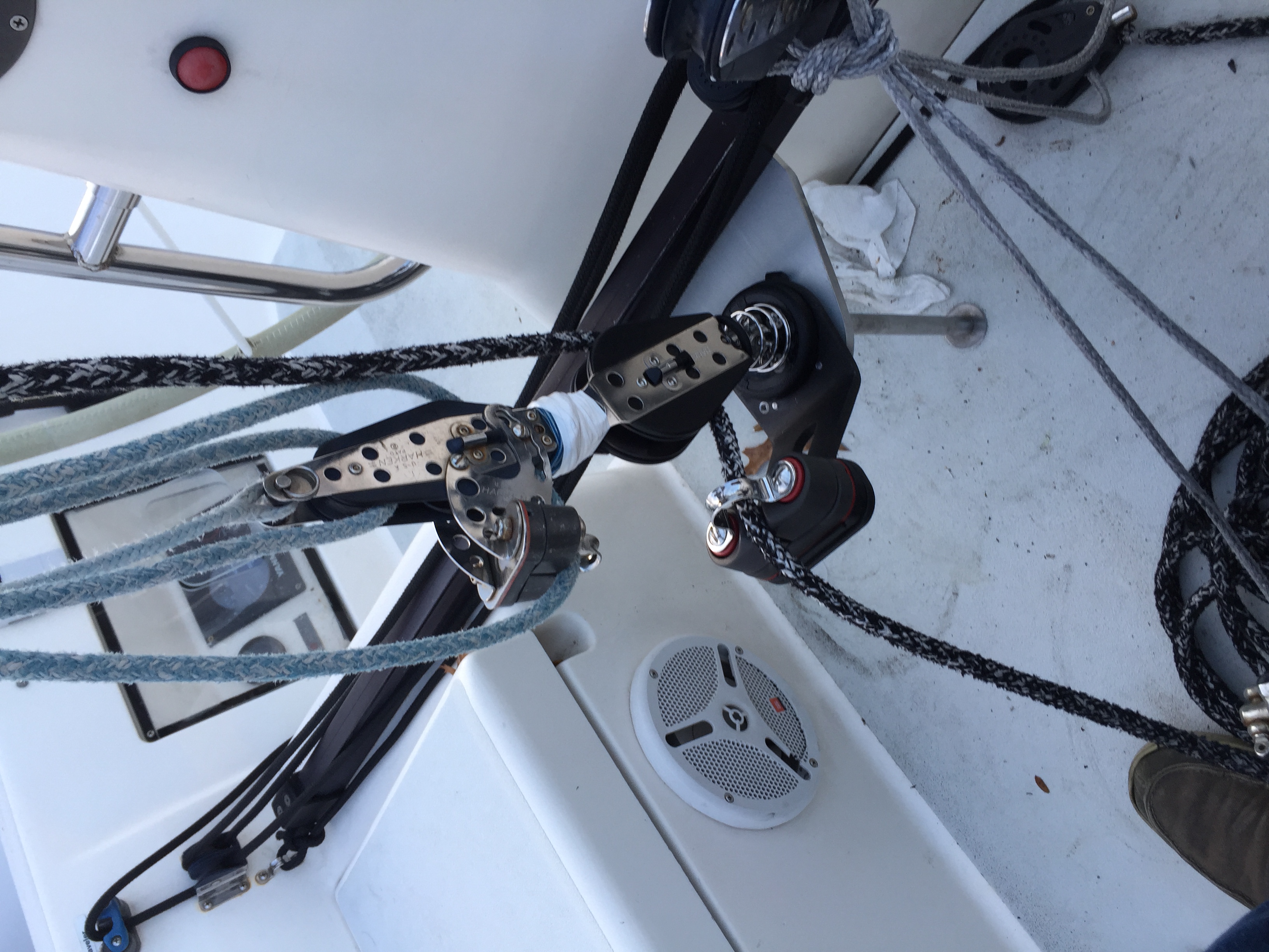

I also received an email from Kurt Larsen on 3 December with the following information and picture. Subsequent to this email, the modified approach was approved by the Technical Committee.
I installed the mid-range block on “Rush” as an emergency repair during the recent championship regatta. During that regatta at least 3 boats broke their mainsheet swivels. The swivel base itself is what broke. Not the cam arm or the “U” adapter. The midrange block has a wider footprint but still fits on the existing aluminum platform. The larger base uses 1/4-20” fasteners and I positioned the aft one so as to replace the existing tie rod fastener which is also a 1/4-20”.
I just upgraded the swivel on “Freedom” with the midrange and made a new aluminum baseplate to eliminate the extra holes from the old swivel. Picture enclosed.
The day after I completed this I heard that the class has not yet ruled on this. This upgrade does not change the sheeting locations or the amount of purchase and is identical from a competition standpoint. As a larger and more robust fitting it should be far less prone to failure.
