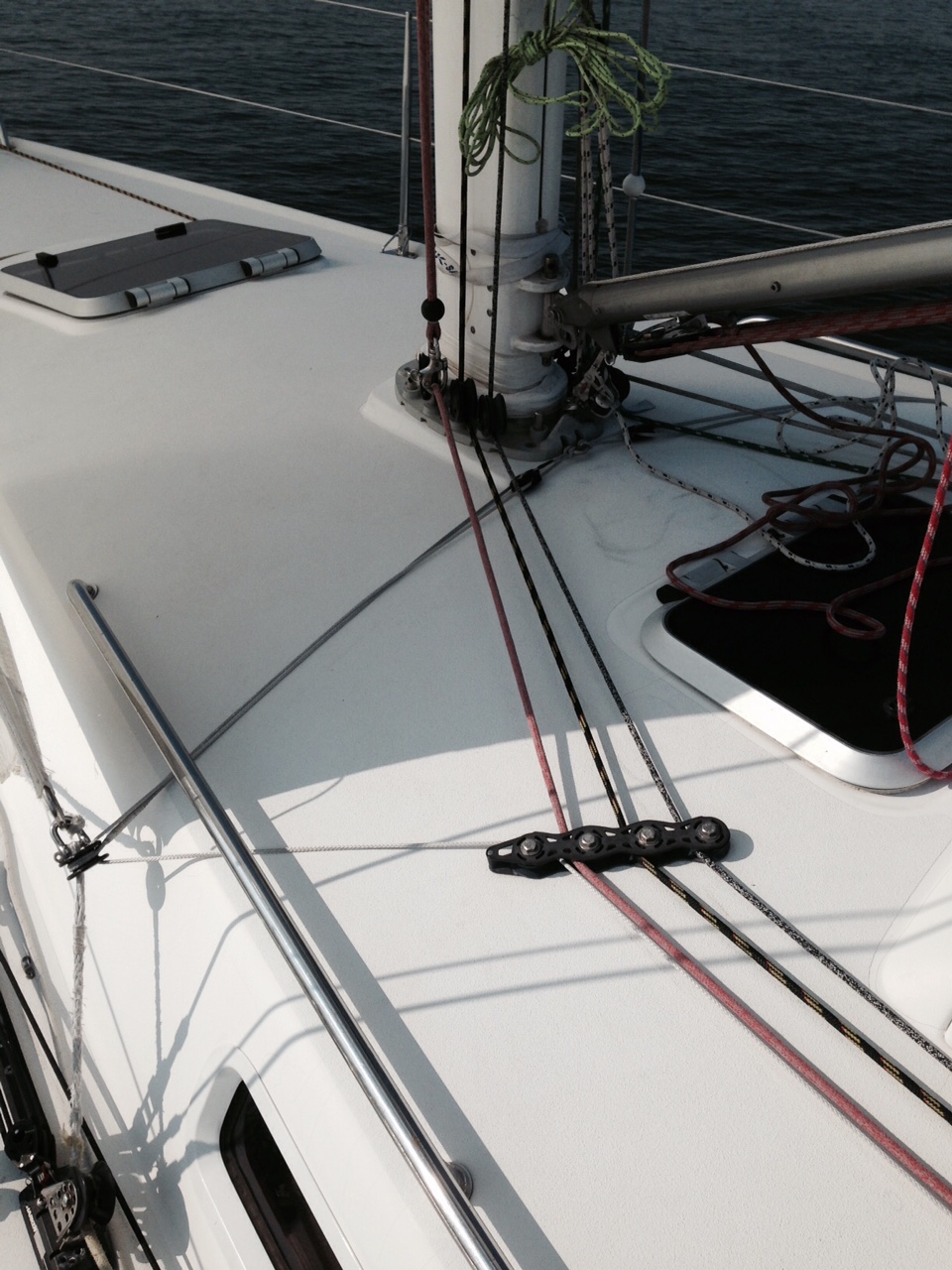

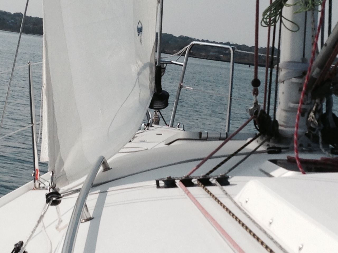

The headliner must be removed in order to mount the cheek block and cam cleats. The cam cleat is mounted just outboard of the cabin top winches, about 1/4" forward of the aft cabin top edge. The cheek block is mounted just forward of the molded lip that supports the dodger, just outboard of the halyards. Make sure to epoxy isolate the holes so that the core integrity is not compromised from potential water intrusion. Once the blocks and cam cleat are mounted and fasteners tightened, the excess screw lengths should be trimmed off and ground smooth.
Harken 2163 cheek blocks with becket are screwed to the cabin top for the inhauler just forward of the spray hood.
This is the same Harken 2163 cheek block shown without the dodger in the way.
Temporary line is routed in a trial fit of the jib inhauler. The control line starts at the becket of the Harken 2163 cheek block, runs forward to the small sheave on the Harken 2655 Carbo Fiddle block, back aft around the sheave on the Harken 2163, forward and around the large sheave on the Harken 2655, then aft to the Harken 150 cam cleat. The resulting purchase for this portion is 4:1.

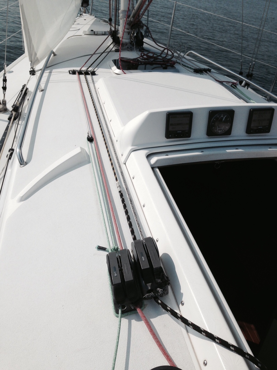

A Harken 150 cam cleat was installed on port and stbd side for the new jib inhauler
The deck organizer has been expanded by stacking a Harken 6054 dual deck organizer on top of the existing organizer. This eliminated the requirement to drill additional holes on the deck for a 6 sheave deck organizer. It did require removing the headliner to install longer replacement bolts.
Small polyester line is being used to check the routing and length of the Dyneema line that will run through the Antal ring to inhaul the jib sheet. The line is attached on both port and stbd Harken 2655 block so that both port and stbd inhaulers may be adjusted from the control line on either the port or stbd side.

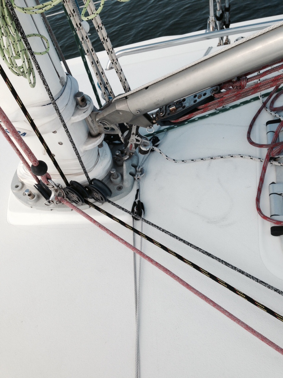

This view of the port side is similar to the stbd side. There will be an Antal ring attached to the center of the mast base to allow the Dyneema line to be crossed over to the opposite side. Only one line is under tension at a time, depending on which tack the boat is on. Actual routing of the Dyneema above or below the handrail will need to be resolved once the system is tested with the new class jib.
This shows an Antal low friction ring attached with a Dyneema loop at the mast base. The real Dyneema inhaul lines are shown threaded through this ring, as only one is under tension at a time.

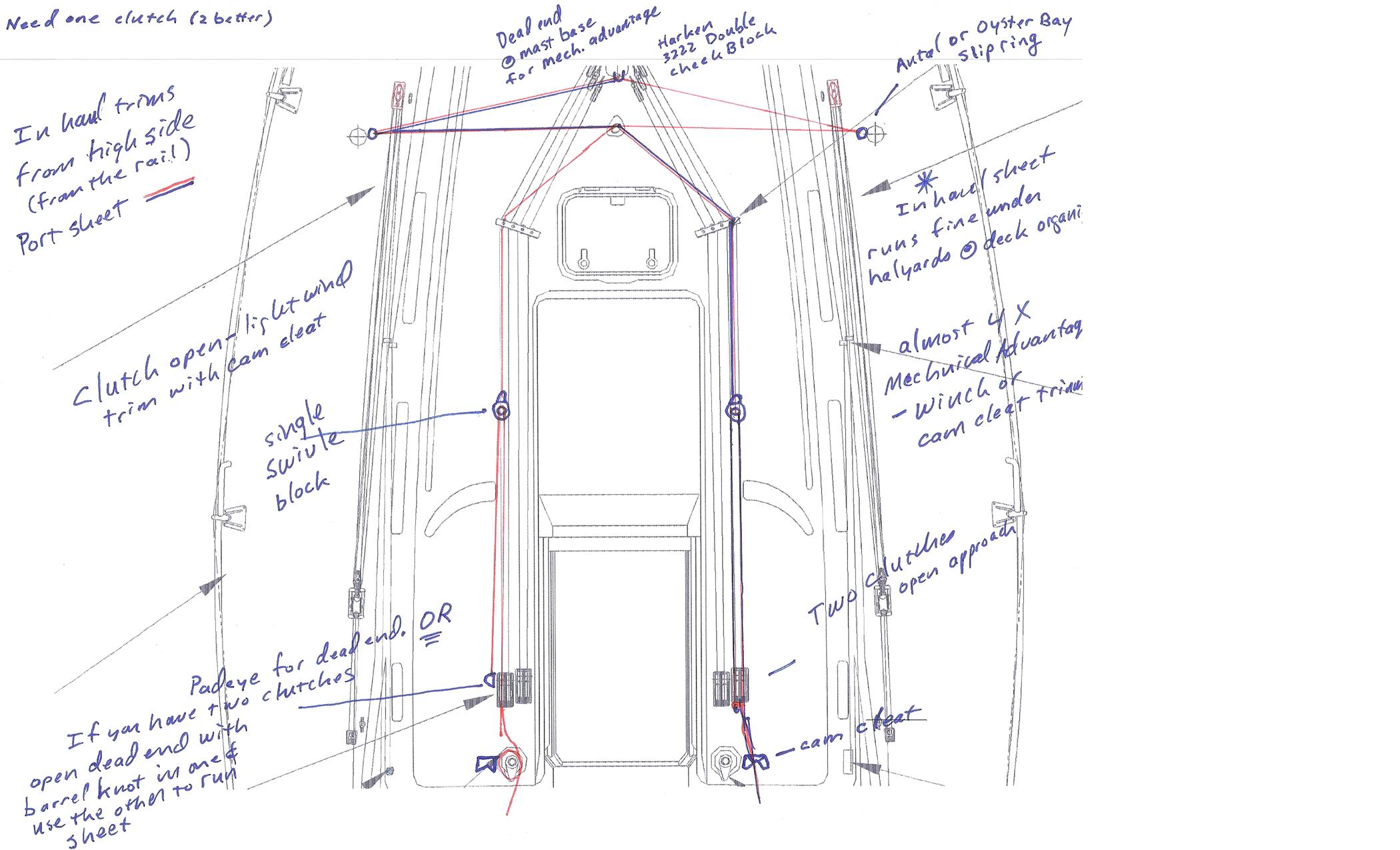

Picante Jib Inhauler System
John Sahagian sent me the following diagram for the system he is installing in Picante.
" It all comes off for cruising except the double cheek and the cam cleats which my kids would have to work at tripping over."
